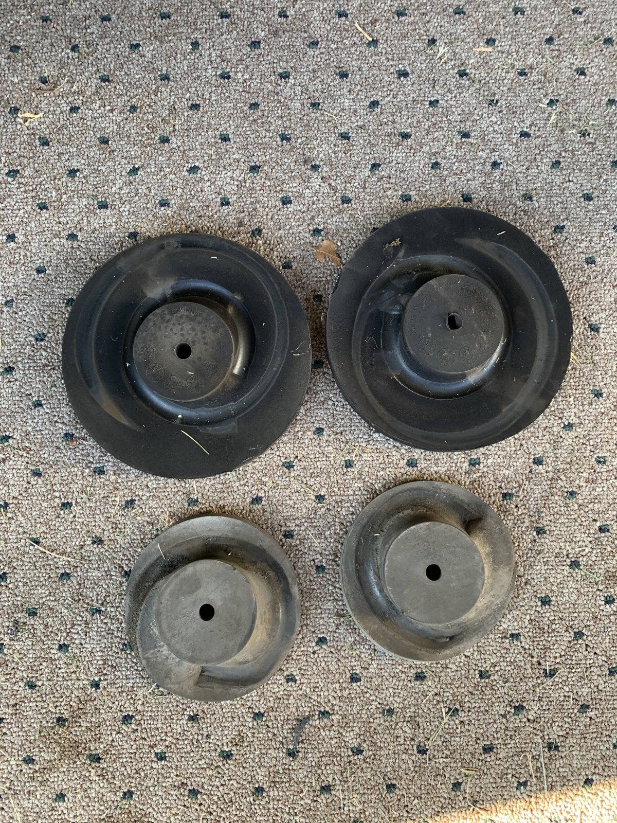

I have read somewhere that the issues with the snap rings on the 5100's are when people reuse them after an adjustment. Using new rings each time supposedly poses no issues. I'm quoting from a sketchy memory, so take it for what it's worth.
In my case, on the top posisition it was well over 2" of lift and I've beat them to death with no issues (yet).
As far as a recommendation, I'm biased. I love these shocks.
