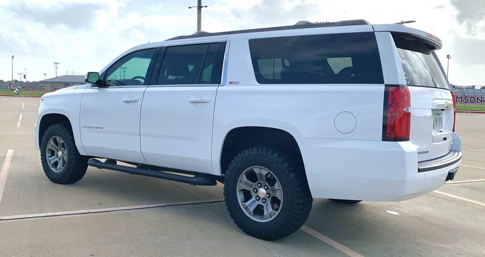

Yea looks great! If thats at least 2” up front, I am guessing you lifted the back a bit too then?
