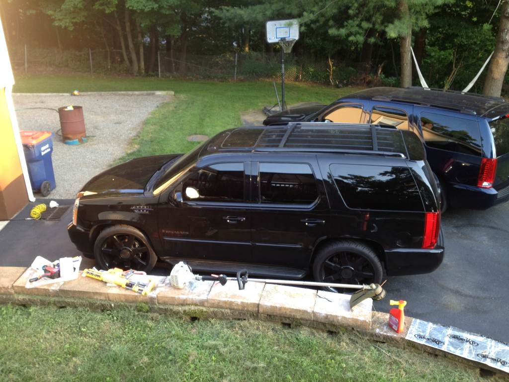

The picture I posted was how I installed the spring perches wrong the first time. In your picture everything appears to be fine. I would check the part number that is stamped on the shock and look it up. It's at the bottom of the shock so you should be able to see it. Like Tony said, it's possible whoever installed it got the Bilstein 5100 series shocks which allow you to raise your vehicle.

It was about an inch from fender to tire now it looks like someone stole my engine toousybydyg.jpg

Maybe you had lowering struts before and didnt know.

Never thought of that
Thanks
Will the lowering struts by bell tech be a comparable ride to the bilstein
What do you guys use for a lowering strut
