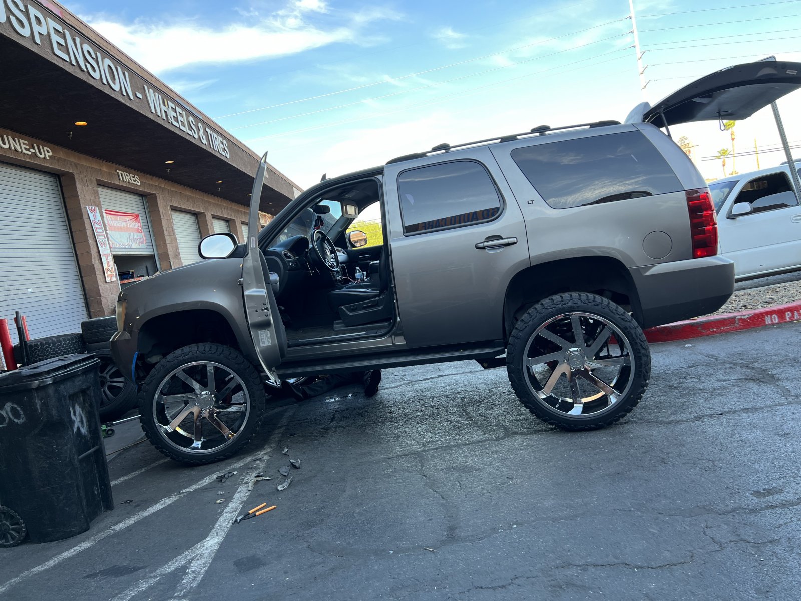

So I got a 07 Tahoe who the previous owner says had a DOD delete. It flashes a check engine light time to time which causes it to fail emissions. When you scan the truck it gives absolutely no codes. Did they do the DOD delete mechanically but skipped tuning ecu? I’m so lost?! Mechanic suggested a top end rebuild. The truck drives perfectly fine. If I pull the Maf sensor it gives me a code so I know it’s not having issues spitting codes if there’s an issue.
