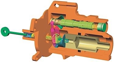

Well, like @exp500 said, could be something as simple as flushing the power steering fluid. You said "no booster" but you either have vacuum boost or hydro-boost and I am assuming hydro-boost. Have you checked the brake fluid level in the master cylinder? Flush brake fluid too.
Could you explain the power steering fluid part to me? I'm confused as to why it might be that since it says service brake booster

You'll have to figure out what system you have. Hydro-boost brake boosters use the pressure of the power steering pump to power the brake booster.
