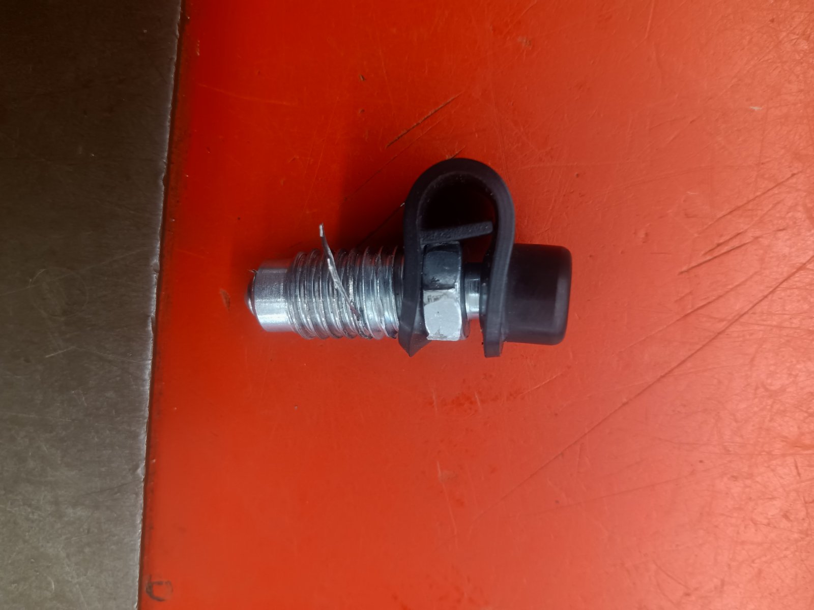

you're probably seeing the quick bleeder style bleeder. as said, it's just sealant because how those work is you loosen them, they have a one way check ball in them so you can pump the brakes, the sealer is there so doesn't suck air thru the threads. when tight they sell at the bottom.
you have a issue with the cone at the bottom of the bleeder or the caliper. pull the bleeder out, blow out the hole and look for any crude in there. check the bleeder that the base is a smooth cone shape. and then put it back together. or return the caliper as bad.

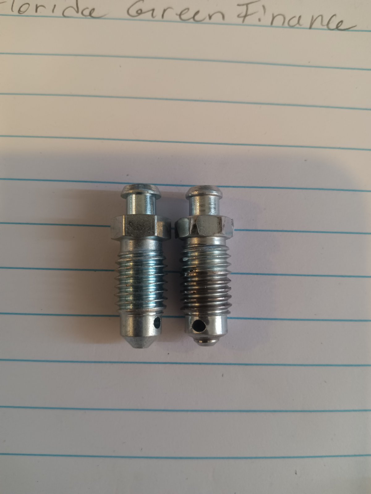

I'm steaming over here. As I said before, nothing comes correct anymore This is the bleeder I took out of the passenger side caliper (havet installed yet), metal in the hole and threads split, burr on bottom surface next to "cone" ( it's not even a cone. Guy at AutoZone says, u can return the caliper ..mfr, I'm not taking this off again. Look at the difference between what cam in the caliper (on right) and a Dorman universal replacement.IMG_20230514_141634.jpg

put in the Doprman replacement bleeder valve and still having a seep. I have to stick the corner of a paper towel into the space between threads on the bottom of the bleeder and keeps coming back wet.
WTF - I'm so annoyed. if I pull this caliper and get a replacement., whats to say the replacement won't do the same thing?
ugh - this is some bs.

I'm steaming over here. As I said before, nothing comes correct anymore This is the bleeder I took out of the passenger side caliper (havet installed yet), metal in the hole and threads split, burr on bottom surface next to "cone" ( it's not even a cone. Guy at AutoZone says, u can return the caliper ..mfr, I'm not taking this off again. Look at the difference between what cam in the caliper (on right) and a Dorman universal replacement.View attachment 399287
this is what I was talking about, it might need to be reamed, might have to bite the bullet and just exchange it and be done with it.
