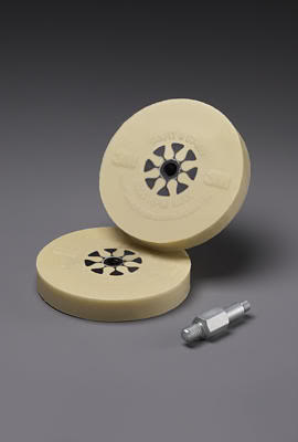

i used a 3m decal/pin stripe remover rubber wheel. The tool is about 20 dollars and carried by must auto body suppiy shops. Way easier then rubbing over the glue back and forth and no chemicals needed just wax.
