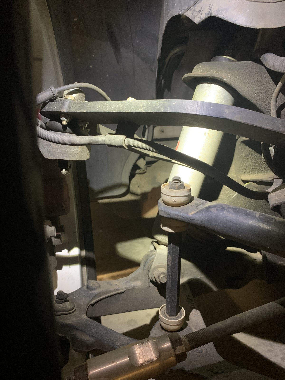

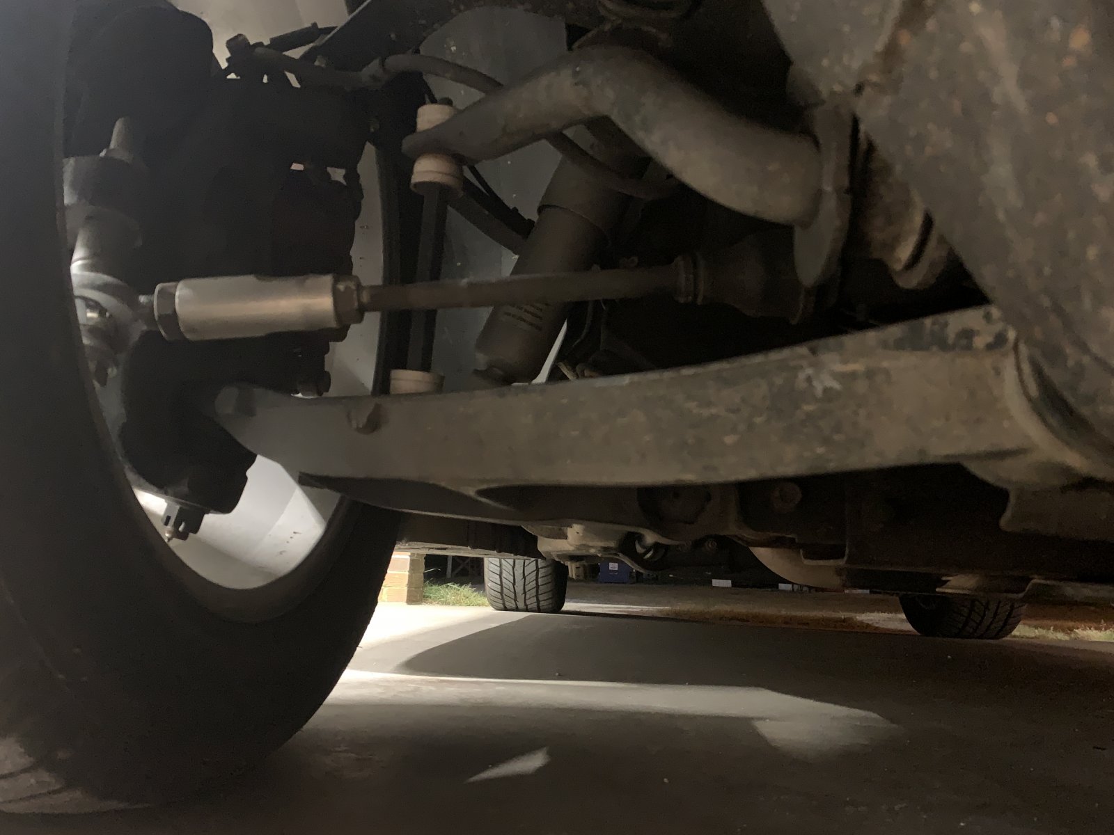

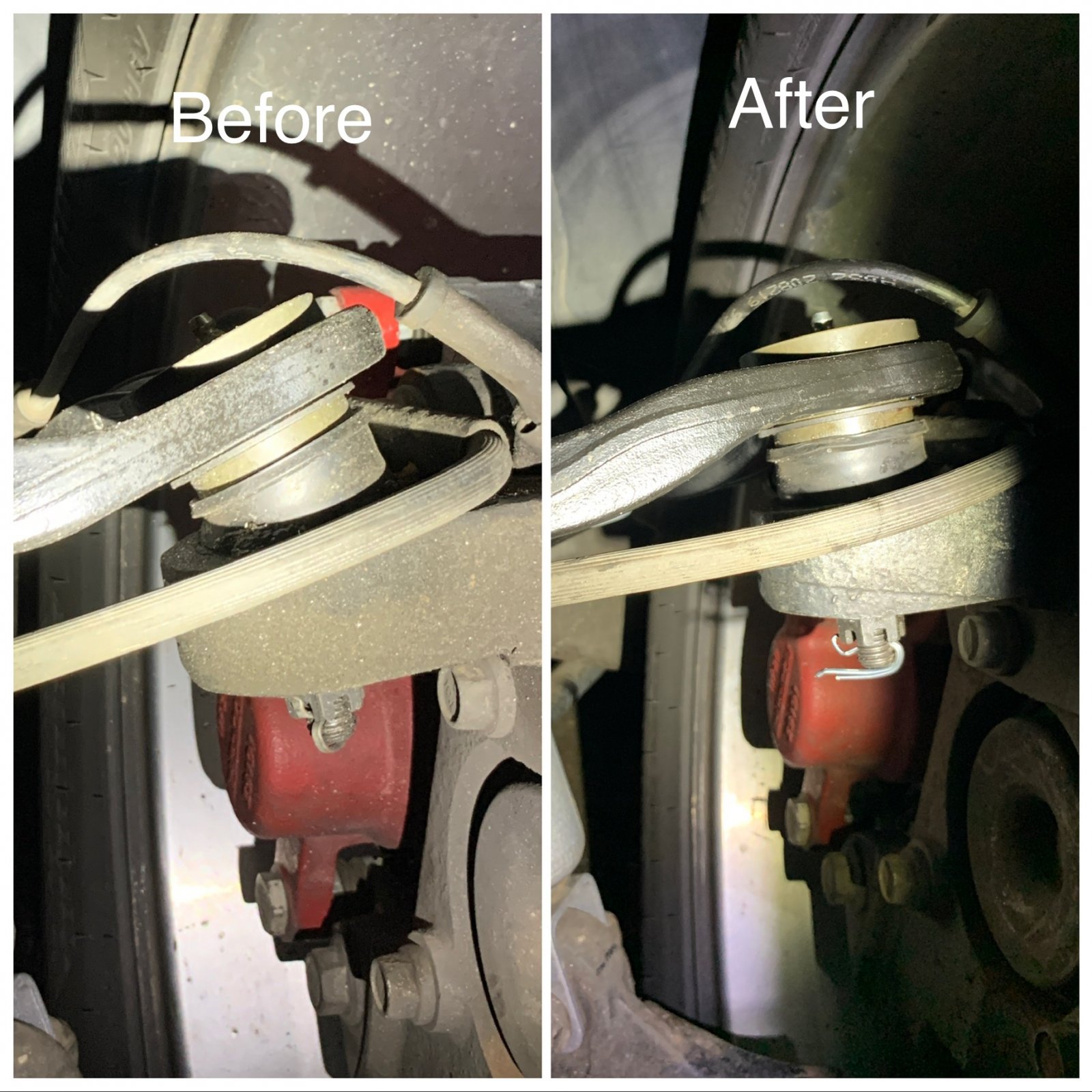

I’ve done the balljoint flip, and offset bushings.
I have a set of moog offset bushing arms with balljoints flipped for sale in the classifieds section right now.
Here’s the pics from my truck once I did this mod.
44,967
View attachment 354833I’ve done the balljoint flip, and offset bushings.

Michigan metal works camber cure uppers, and a bumpsteer kit got mine dialed in perfect alignment.
I could go 3” lower and still have no camber LOL. They are way longer than stock uppers.
Drilled and tapped a hole for the brake line,painted them
Black that was about it.

Did you have any camber/alignment issues after flipping the stock UCAs? I know this is primarily for BJ angle, but, I understood it to also help with camber.
Never tried it with “stock uppers”
Only tried it using moog offset bushing control arms.
They reduced the camber by 2.5 degrees, but I had 4 degrees of camber.
The belltech camber kit is a total waste of money, and made super flimsy also. Absolute junk quality.
In the pictures above I had Michigan metal works arms, combined with belltech camber cams… immediately swapped back to stock cams as the belltech cams would not clamp tight against the frame.
My truck required longer control arms. Which I purchased through Michigan metalworks.
