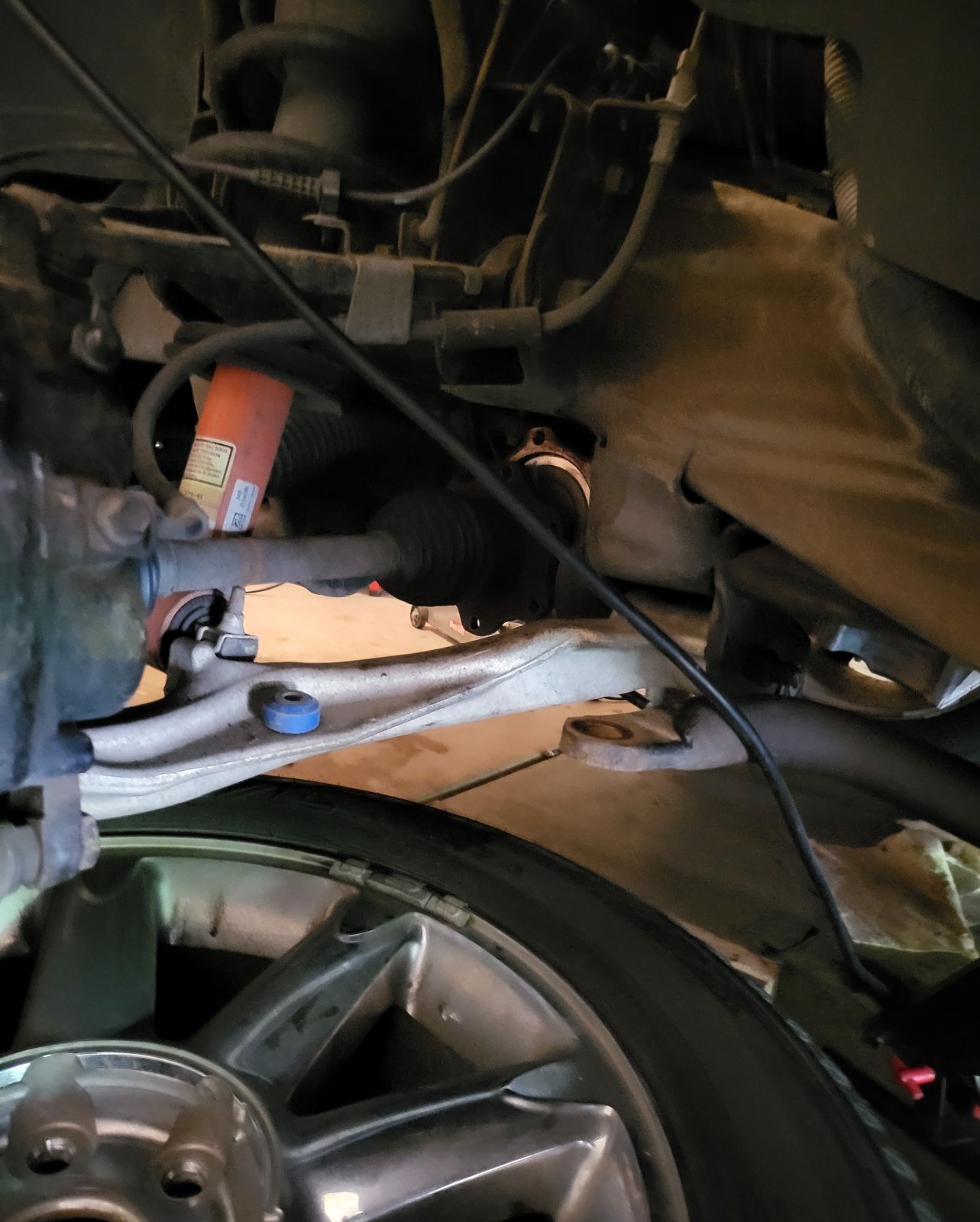

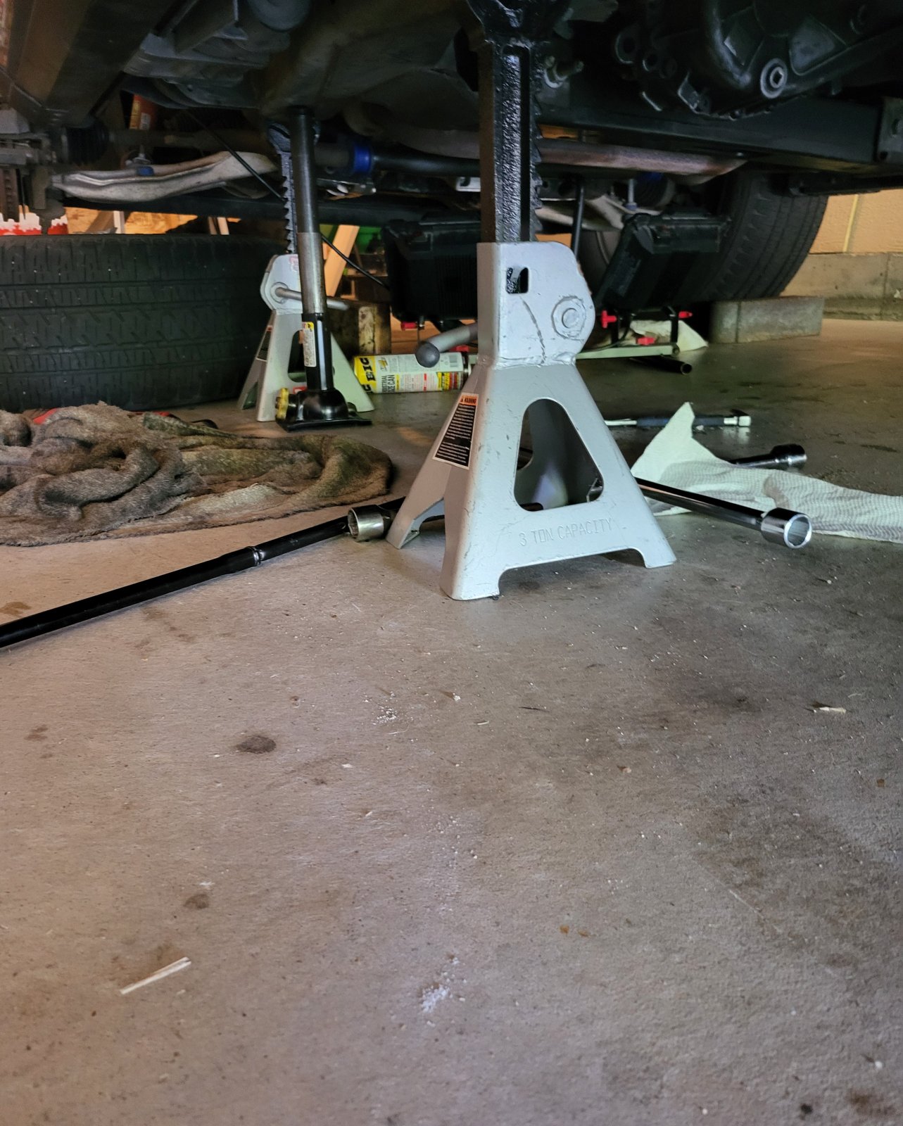

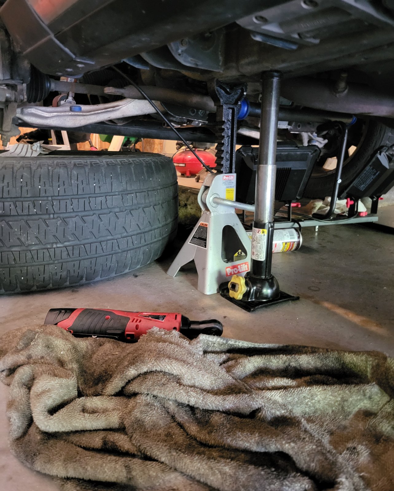

Can I drop my differential safely with the cv axles disconnected or will my vehicle front end fall
mrs111180
Dec 1, 2020
Can I drop my differential safely with the cv axles disconnected or will my vehicle front end fall. (Swayber disconnected, cv axles disconnected
