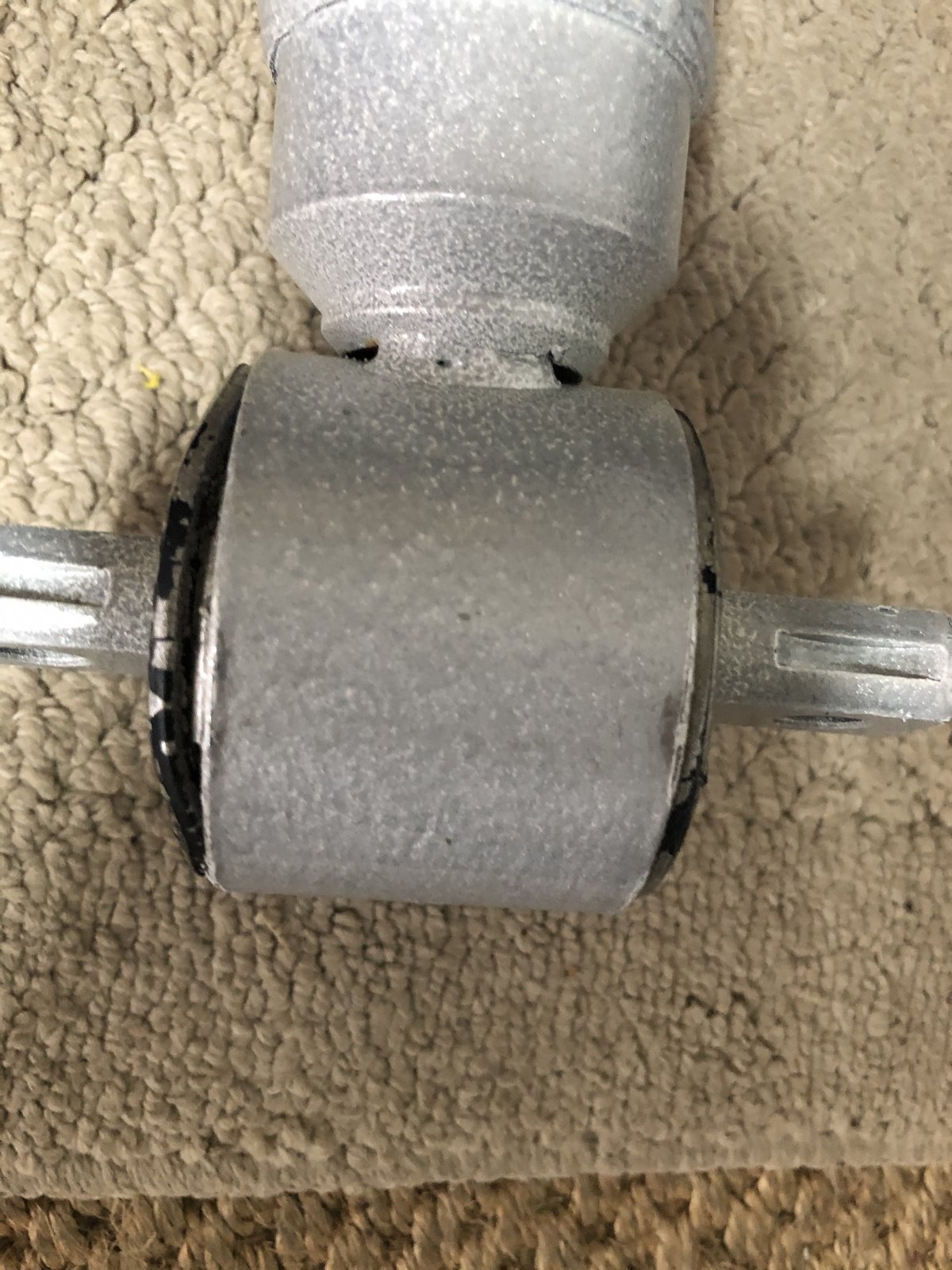

Just received my QuickLifts today. However, there appears to be some damage to the lower strut mount. The rubber appears to be protruding from the mount. Is this critical? Thanks! CBD703C7-9C95-4C15-B2DA-E0A922C23DD1.jpeg

@Dustin Jackson, it doesn’t appear to have been used. But I did notice the left side of the lower strut mount was protruding from the housing. And the package it was shipped in was damaged. Most likely from the weight of the strut, since it was free floating in a very flimsy cardboard box. Smh..

It should be fine.
