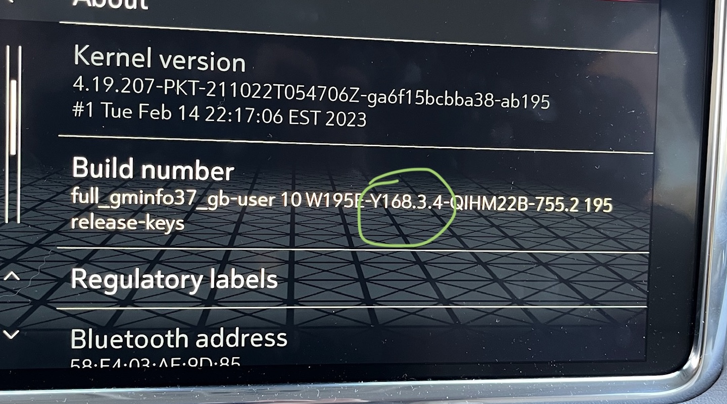

Is the update you’re referring to not an automatic over the air update? Is there a way to check my current software version? Thanks!

Not automatic, had to have the dealer install it.
You can do a Settings -> System -> About and find the Software Version.
Is the part I circled in green the part you were talking about? Y168 on mine
