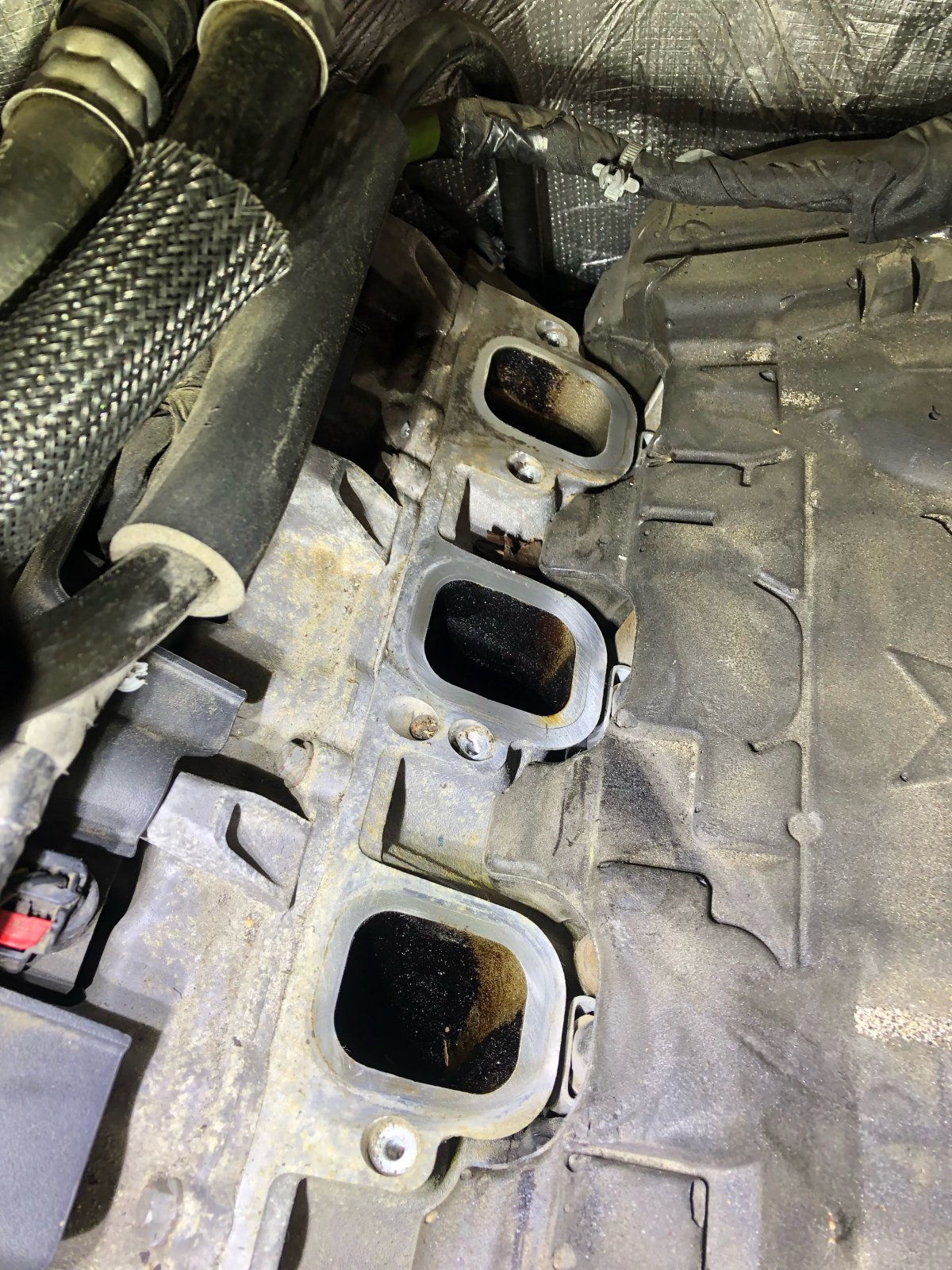

About 160k miles. It’s used by my wife for kid transport so makes tons of short trips. Mostly city driving.
I bought it used when it had 104k on the clock. It had no catch can on it for all those miles and I had to pulled the intake to clean the intake valves. They were coated in oil. I mean caked!

@ReaperHWK
Thanks for sharing. It is crazy what happens to the intake path on the DI engines with no fuel behind the intake valves. While it can be cleaned up, it is no fun to do or can be expensive. Wonder how many engines have had larger sections of carbon break off and cause problems within the cylinder(s)?
Too bad the vehicle did not have a catch can from day 1. While it may not keep the valves pristine, I am sure they would have far less carbon and oil build up on them with a catch can.
I know some of the Fords are using both Port and Direct Injection on some motors. While I do not think the Port injection is specifically for the intake valve deposit build up, it probably helps a lot on those engines.
