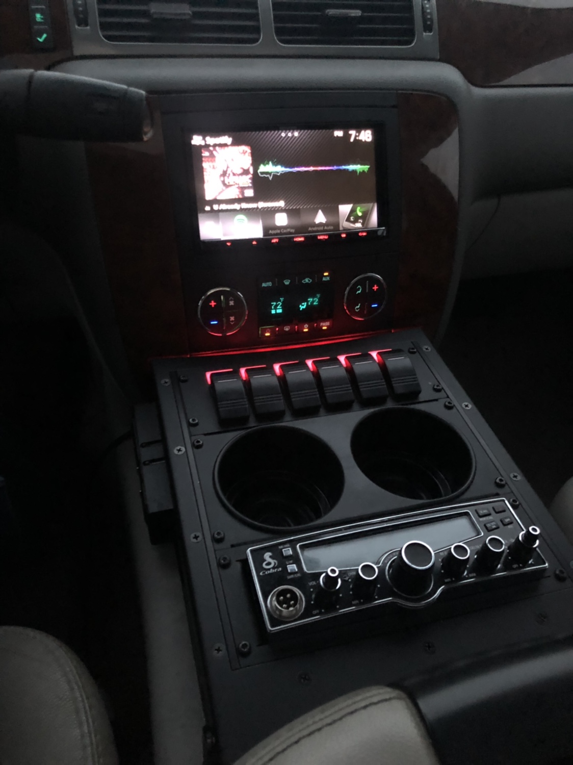

where did you get order the cruiser mount? I am installing one in my 08 yukon xl and like the looks of that

Good stuff here guys. Where do you find those custom center console mounts and switches and stuff?
I ordered mine from www.Responderpse.com. Shipping took 4-5weeks since the product company (Havis) doesn’t stock these, and has to make them per order. The different inserts; CB mount, cup holders, switches, blind panels, can all be ordered on that website as well.
Console (C-VS-1000-TAH):
https://www.responderpse.com/2007-2014-chevrolet-tahoe-gmc-yukon-vehicle-specific-10-in-console.htm
Cobra CB mount (C-EB25-068):
https://www.responderpse.com/havis-c-eb25-068.htm
Switch filler panel (SP-6SWC):
https://www.responderpse.com/brooking-sp-6swc-switch-panel.htm
Cup holder (C-CUP2-I):
https://www.responderpse.com/internal-cup-holders.htm
