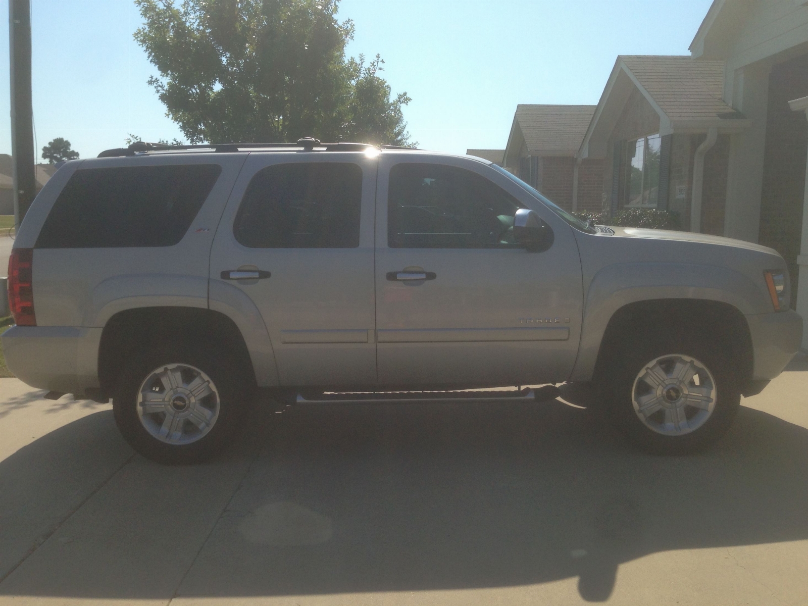

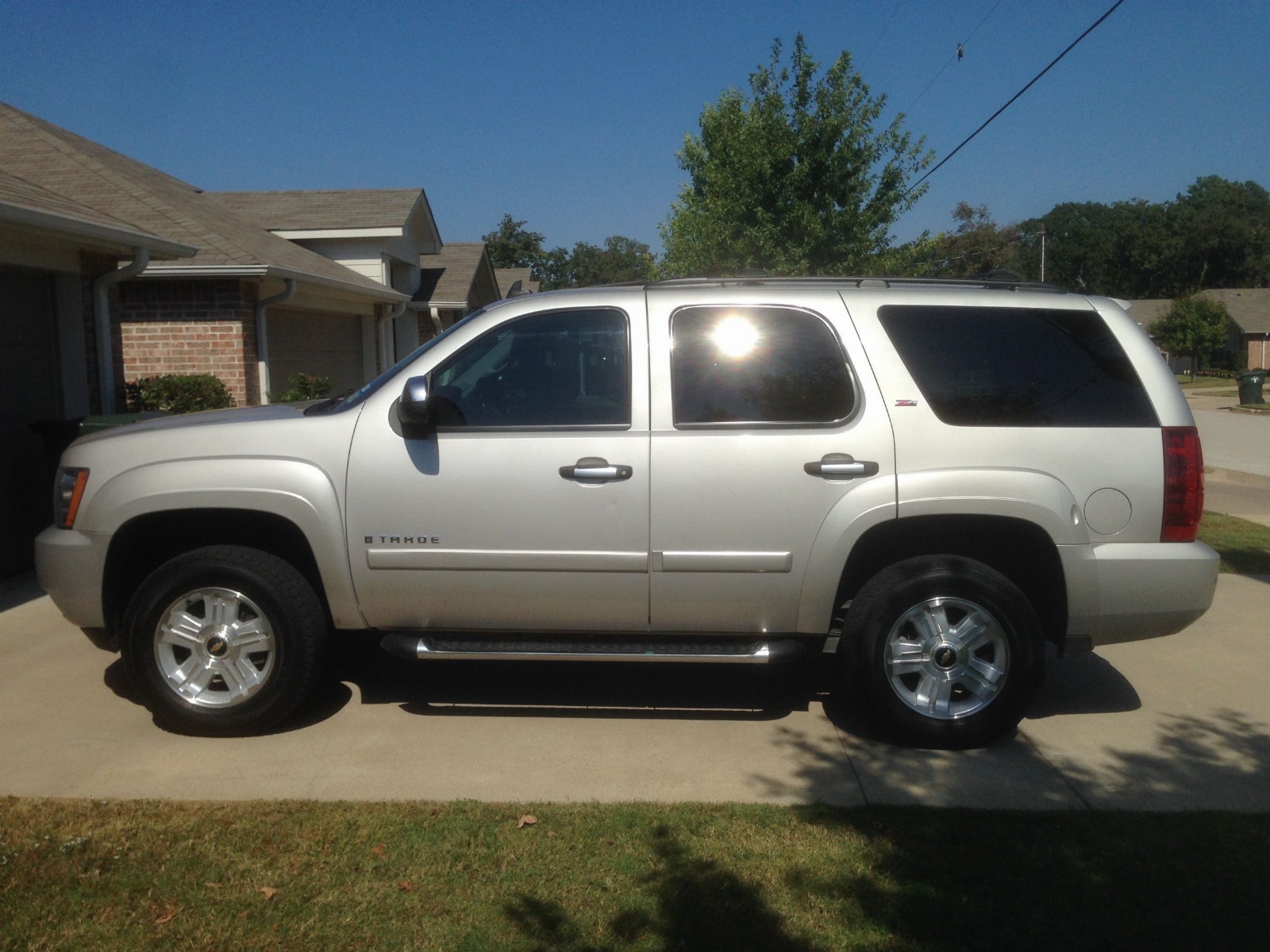

With the CCM 2.5"/1" level kit, will the truck squat (cali lean)? I have an 08 Z71 Tahoe. I definitely don't want the squatting look - but it seems to be the most common level kit from CCM. Right now I'm running 265/R18 AT tires - but would definitely like to upgrade to a 285 with meatier tread.
Just don't want the truck to look lower in the rear if I buy this leveling kit as opposed to say a 2.5"/1.5" setup.
Any advice would be great. Thanks!

Mine was 0.25" higher in the rear with the 2.5/1, but just eye balling it the front slightly looked higher depending on terrain/angle. If you are concerned about that, just get the 2.5/1.5. IMO looks better with a slightly higher rear and won't be lower than the front if you are carrying a load.
I now have an airlift bag in the back which gives me 1.5 to 2" at the back.

Thank you sir! I rarely carry a load bigger than my two 90lb labradors, so hopefully the 2"/1" is will be good. If it ends up being too low in the rear, I can always buy just the 1.5" rear spacers on eBay or something down the road.
Another concern with the 1.5" rear lift is getting in and out of my garage - and I definitely want to be able to park in there.
