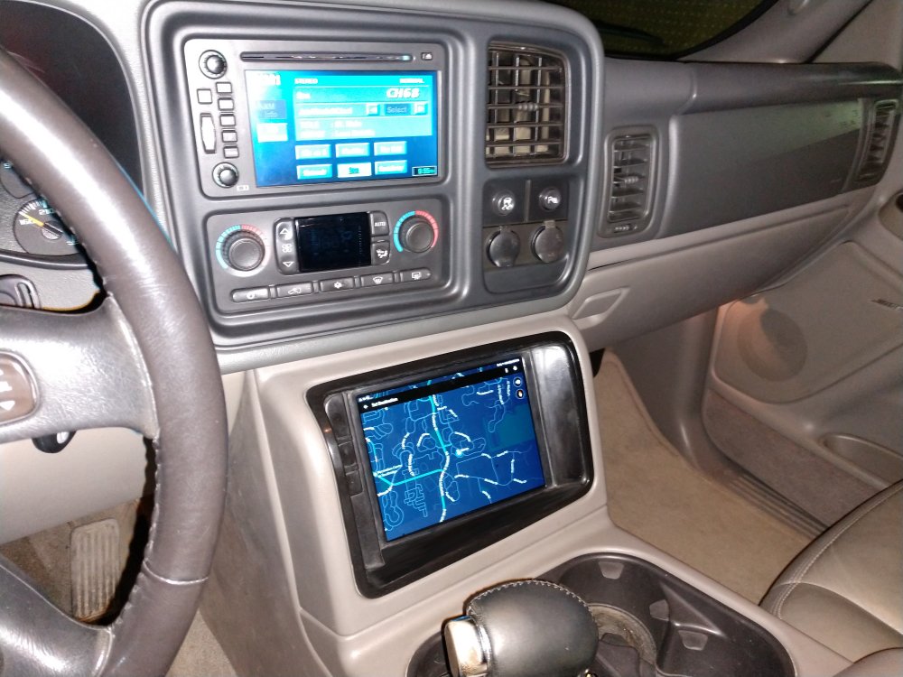

So question the steel bar u used u mounted to the console with bolt to to the console (screwed from inside out?) or u mount it to the floor? .. thats pretty damn awesome like that much better!!

The steel bar is bolted to the substructure of the console, and then the outer trim panels were reinstalled, so the bolts are hidden.

Gotcha!! Looks awesome !!! I am looking for a 05 shifter now also do u have a top obove shifter picture? See how u didnthe cut

Too bad the shift indicator is still up in the cluster instead of by the shifter. Seems kind of weird. Other than that it looks good.

BTW for anyone interested in doing this, here is the GM part number for the manual transmission steering column shroud to eliminate the shift lever hole.
26089146
Since I got the Trailblazer shifter off ebay, I don't know that part number.

I know this is an old thread. What did you do about the interlock solenoid on the shifter? just remove it or did you wire it in?

I'm sorry, I know this is a really old request, but I just noticed your question. The Trailblazer shifter has an interlock solenoid, and I could have extended the wires and connected it like I did with the Tow/Haul switch, but I like not having to step on the brake to shift out of Park, so I left it disconnected.
