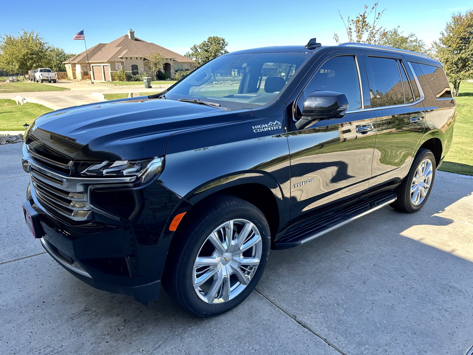

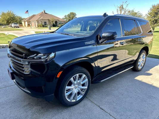

Here is my black Denali Ultimate that was recently finished. The paint correction is the most important part and mine from the factory needed it. Mine was done with 450 miles on the vehicle, the deep gloss black is fantastic now and not a scratch or swirl mark on it,
