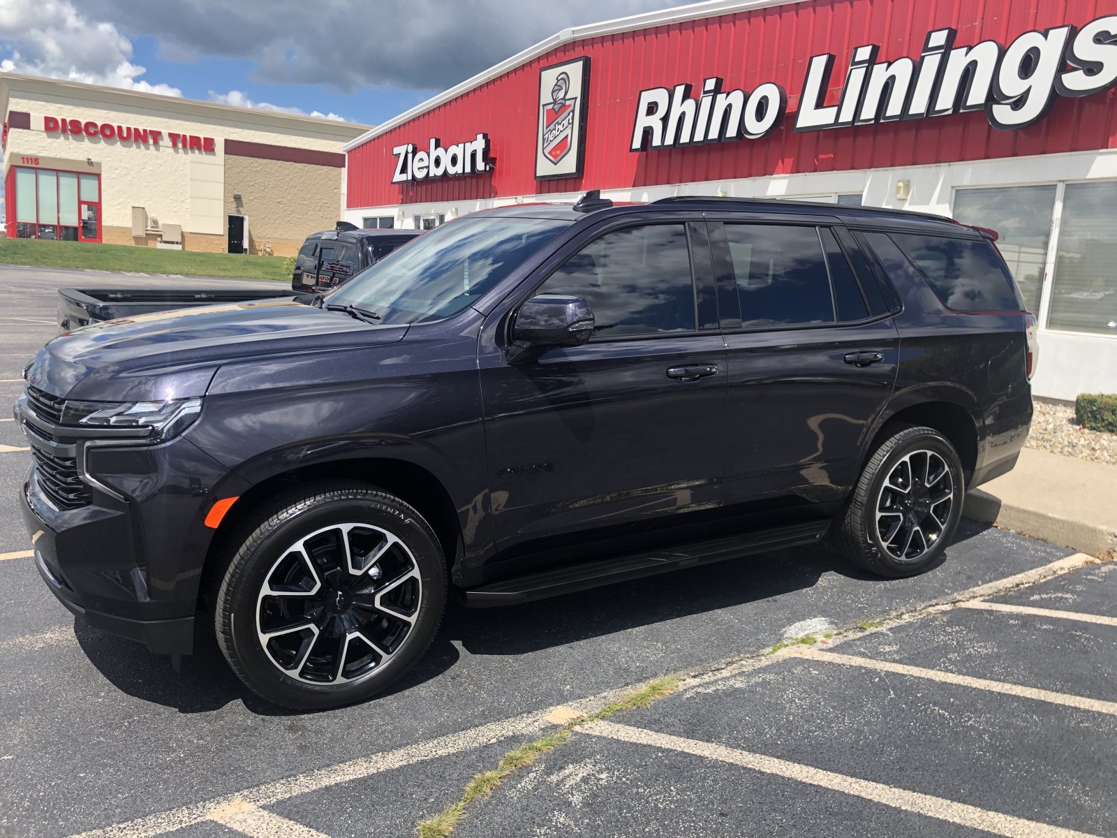

Had a ziebart zgloss coat put on today. Looks great. Will see how it holds up.
