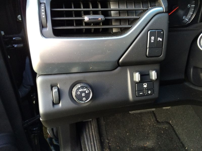

Max towing package trailer brake controls with appropriate trim panel - just need to get the option activated now. The plug is present and appears to be fully wired up.

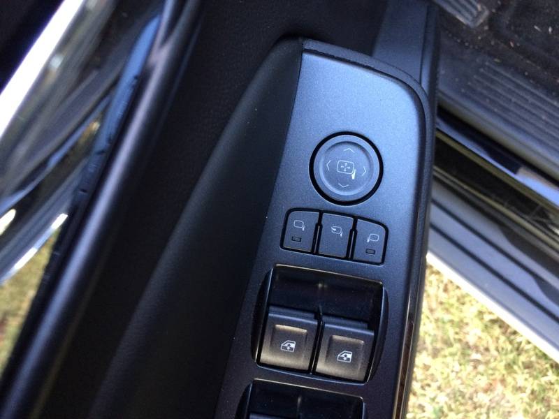

Prep for power folding mirrors with turn signal integration - the power fold works but the signals do not, so until I get that detail sorted I still have the base mirrors installed.

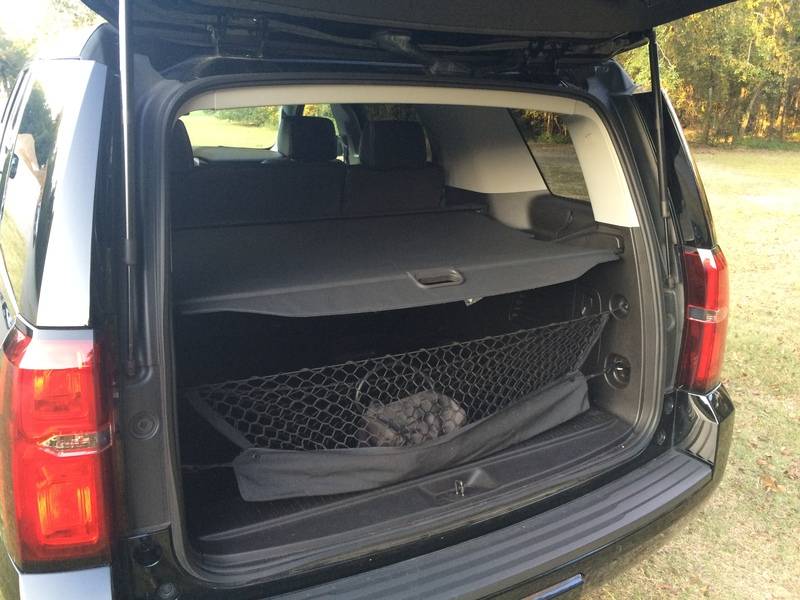

Rear cargo cover and rear cargo net.
