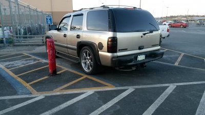

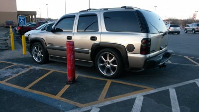

UPDATE:
I have some good news to report back. After a long week of picking Richard (atomic) and Mike (tahoewhat) brain, and fooling with the suspension, Im back in the game.
I turned the coil overs up to try to get into more of the middle of the travel of the shock. I gave a shot for a few trips and on the highway it was oscillating out of control wasn't safe. I was worried and feared the worst i was going to have to remove the swap which I REALLY LIKE. After talking to Richard about a million things it could be, he said try turning the shock setting all the way up and give it a try. So i jacked the knob all the way up, it took me all week to take a test run. Finally yesterday i got out to the highway and headed towards those damn bumps, i hit them doing 70-75 and WOW just turning them it rode great to compared before. Handle the bumps damn good, i even kinda like the ride at setting 18.
I hope i have some adjustment still so Im going to go down a click at a time and hit the same bumps until it goes out of control so i know my adjustment range.
At the moment the things all jacked up, fronts at about 32.5 and 32.75 and the rear i have aired up to 33.25 which is like 30ish psi. I also think I'm not 60% downward travel on piston so I'm going to switch back over to the stud top with some more spacing on the stud top, that way i can get to 60% of travel and i want the truck to be around 31.5-32 up front and that will let me air out the back to 32.25 which i usually run 5-10 psi in the bags. Hopping that works and lets me get into right ride height i want. Ill be doing that once i have some free time for now I'm driving like it is.
Im VERY HAPPY i solved the issue and did the conversion, it handles great and the wheel just feels smoother and easy to turn. I have a little more dialing into do and get the correct ride height. I will post up more results and updates as i changes things.
Also tossed my 22's on, this is pretty much how she sits now. lowered the back a little since.
