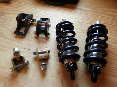

So with those rs702 shocks, you have to convert the stud top to the eye right? With your 5305 springs, do you run shock extenders too?
Yes, convert the stud to a eyelet - (will get part #) No shock ext. I took them off b/c i called QA1 (real nice guys) and gave him my height measurement and he suggested the RS702's as they are the correct shock for my height. Actually it lowered the rear just a tad. You could use shock ext, but as QA1 told me, you are not gaining anything, only a longer shock, but not more travel, (forgot the reason, but it basically cancels itself out if you order the right shock to begin with) and not to mention when lower that extension is pretty close to the ground.
another question... if we think the stock shock mount is probably strong enough, what about the shock mount on my djm lca's? I looked under there the other day, and they're not exactly bombproof, but they also shouldn't really have any side to side stress, so im wondering if (and hoping) the mount on these arms is sufficient to support the weight as well. Then I wouldnt need to buy and install new lca's and this would be a super easy swap
I do not know about DJM LCA, i know atomic only suggests factory. I did not search for that combination in my research, nor did i come across anyone. Looking at pictures i have seen, i would do as suggest by others. Weld a plate or something to reinforce the shock mounting area. i think others have spoken better than i could on that.

i got under there tonight and gave it a real good look and the djm lower mount is really pretty beefy from what i can tell. i really think it would hold up just fine as is. i also read through the whole thread on PT.net and that guy used his stock upper mount for 10k then sold the truck and the new owner reported 20k miles with zero issues whatsoever, so i'm thinking it has definitely held up to the test of time with just the procomp adapter
now im thinking all i need are the shocks and springs up front and may just go ahead and do the adustable bars with shocks and springs in the rear too
As Atomic said, i forgot that guy had a 2500 and belive the frame is beefier than ours, but try it out and let us know if it works alright. I really think it would, but have read some comments that said it started deforming over time. So i dont know. To me this whole setup is custom and with a custom setup comes its share of problems and solutions. I just went the way I saw was a tried and true method for the time being used.

I would love to be the guinea pig for not reinforcing the shock mounts, but im nervous bc I dd this thing pretty hard and haul my family too. Dont really want a catastrophic failure so ill probably just end up going the tried and true route. No sense in forking out the money to go coilovers and cutting corners on safety
Well if its any consolation, i drive my tahoe. It is my daily and i do not baby it. I do not thrash on it either, if that makes sense. I usually only have one other person with me, but i felt putting the bracket just was for a piece of mind, since i do drive it everyday and everywhere. I.E. I do not slam on my brakes to cross a Rail road track, i don't jump it either, but if you have been to TX you know how we drive here and how the roads are always being worked on and "patched" up. I.E. dirt thrown into a hole.
In a quest to go lower it really will not hamper you, if you want that low, then bag it, would be my suggestion. But if you are like me and just want that nice stance,then i am very happy where i am and with the ride still. With kids and family i would do it for safety if you plan on keeping it for quite some time. Or another option, just do it without the bracket & rack up some miles, but keeping an eye on the mounts and see how it goes. That is what i was honestly going to do, till it just slipped by.

Ive been really studying the mounts and doing alot of online browsing and given the fact that ridetech uses the factory upper with their shockwave airbag system, im thinking it is worth a try. Also seems that if shit starts to deform I just have it welded back on with the reinforcement and should be good to go
That sounds like the way to go. I mean you arent baja racing the thing so as long as you keep and eye on it I think it will be fine. If ridetech uses it then it shouldnt be a problem.
