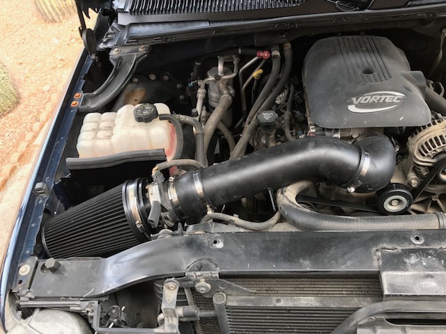

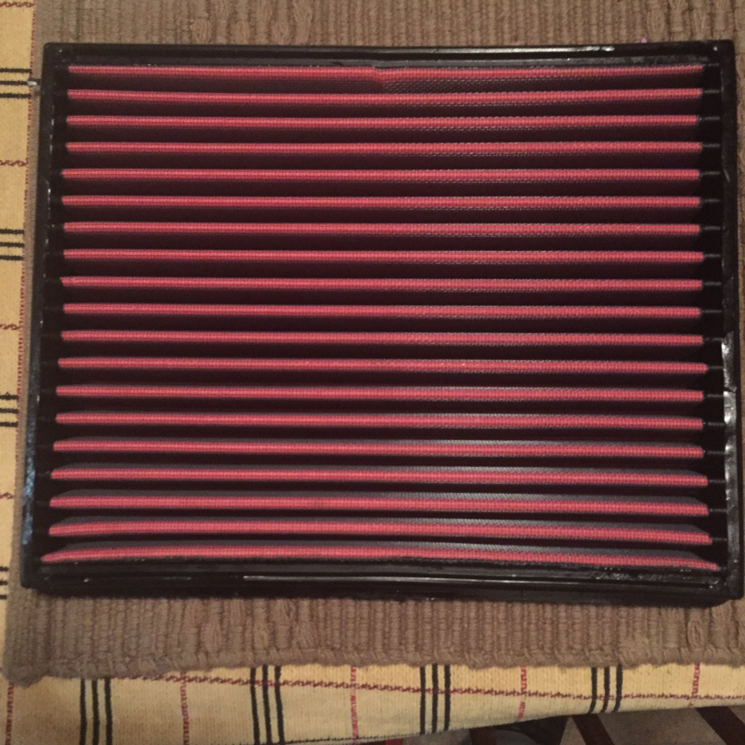

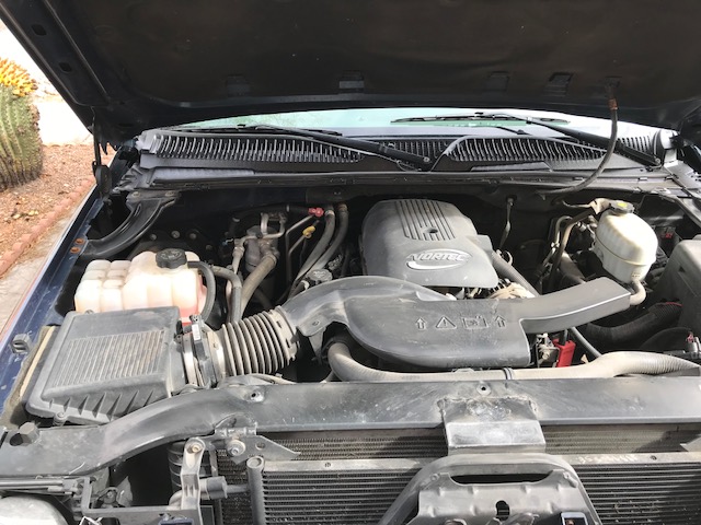

i did some research on this for mine a couple years ago for my 98 tahoe..... the one shown above and others call it a cold air intake is wrong you get a new box for the filter with the top of box open thus you get hot air from under the hood.i went with airraid filter from ebay under 30 bucks installed in stock box on truck which is closed off under hood and draws cold air thru fender
