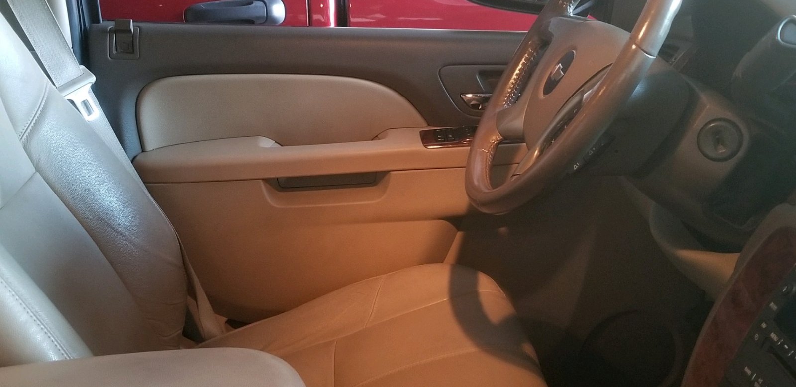

Just replaced mine yesterday in my 13 Tahoe LT. It was a Dorman 80995. Very easy to fix and they have replaced the plastic with reinforced metal and this one doesn't look like it will break. Took about an hour all together as the original has plastic studs that are melted like rivets and have to be CAREFULLY drilled out so you dont lose the mounting surface. I needed the Light cashmere and this matched pretty nicely. They must sell thousands of these....
I do have to add that 2 of the studs had damaged threads and were unusable so run the nuts up and down the studs before install....

Here's a picture.
