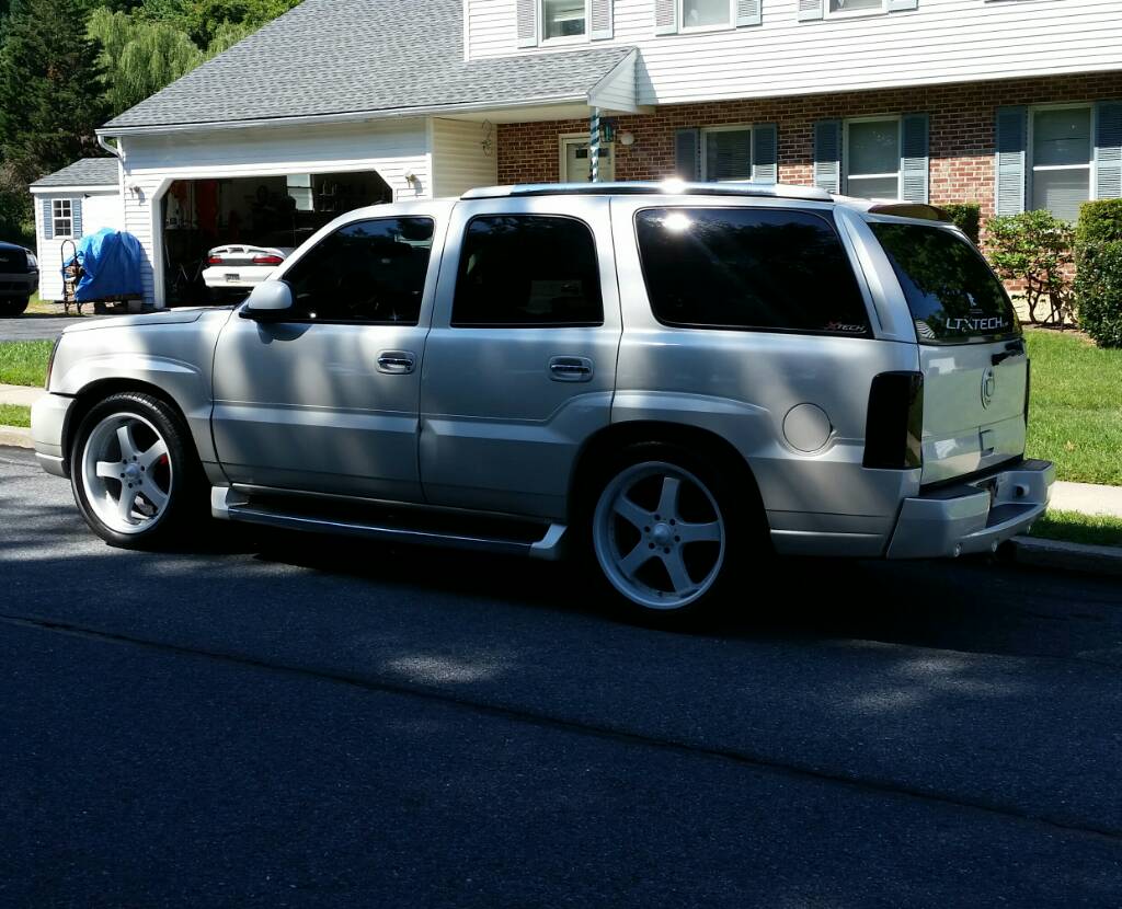

Hey Tony I did the free travel mod today but I don't see how to install the bumpstops- there's no way to get to the nuts. Do you just drill and tap a hole in the frame and use vise grips to tighten the bumpstop ? I made some 2 1/2" Autoride ride links and it sits almost perfectly level now. I'm concerned that if it's loaded or towing a heavy trailer it might hit without those stops installed. Now if those endlinks get here...looking good though.

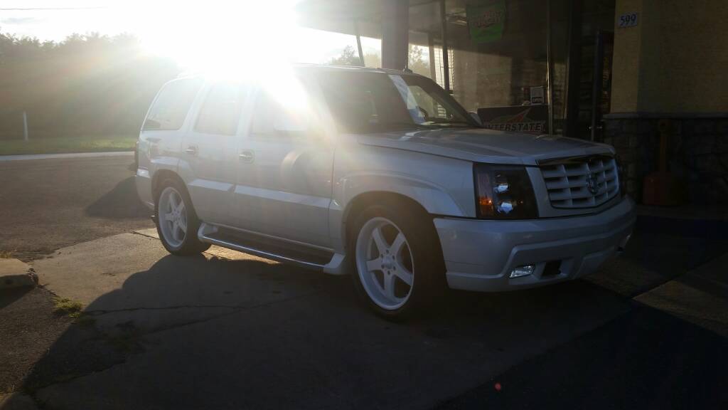

That looks sick!

southboundchicken thanks, I got the bumpstops on. Then the endlinks. Then decided to pull the Belltech shock relocators and replace them with the DJM ones since they space the shocks further down which should have lowered the rear a bit more since the Autoride adjusts it. But no difference there. I was hoping to use my longer 3" autoride ride height sensor links because in the past when I went to 2 1/2" ones, they would pop out of the threads when the suspension was hanging. Anyway, now the 2 1/2" ones stay put when I jack up the frame; guess something changed there and the suspension doesn't hang as far down as it used to. And my truck sits level so all's good. Plus the ride is much better- thanks Tony.

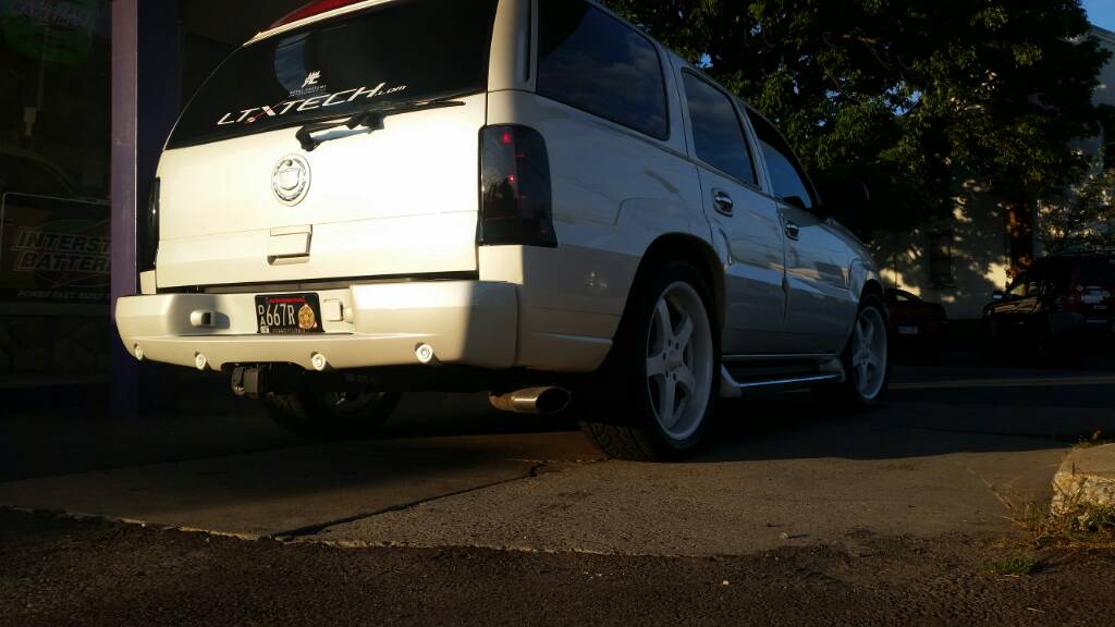

I should have it back 2moro. U want pics of the rear swaybar norco?

yea if you can. Also if you can take a pic of rear bumpstop travel before it hits axle. If its 4 inches almost its going to have no real travel unless bracket cut off frame
