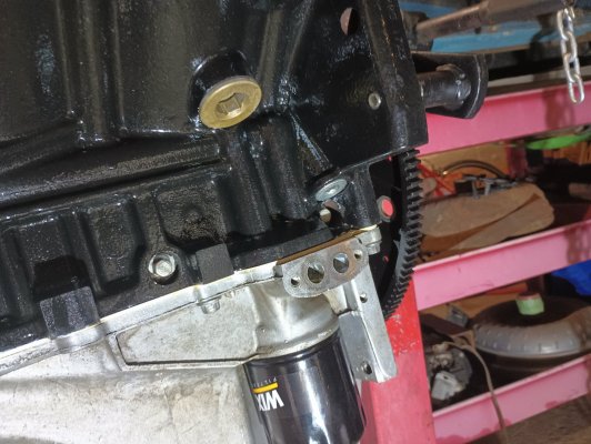

I bought this kit specifically for that plug. It's the largest or second from largest, so either 14mm or 17 mm.
My LQ4 I'm currently overhauling had a block heater installed there. I removed it and installed the brass plug (had one laying around from another engine teardown.)
Just reinstall it with thread sealant and torque it to spec. I think it's like 40 ft-lb, but don't quote me on that.
Wow ! A kit just for one socket. Oh well ...maybe I'll make one....a piece of bar stock...a grinder and a stiltson wrench. What could go wrong ??? ha ha ha......thank you.

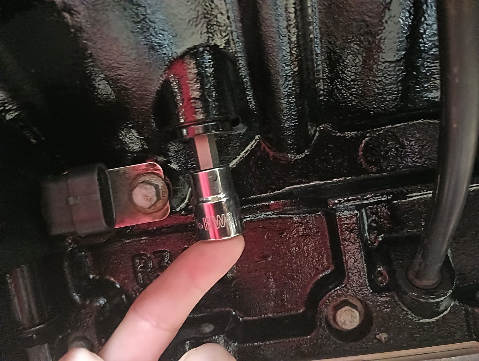

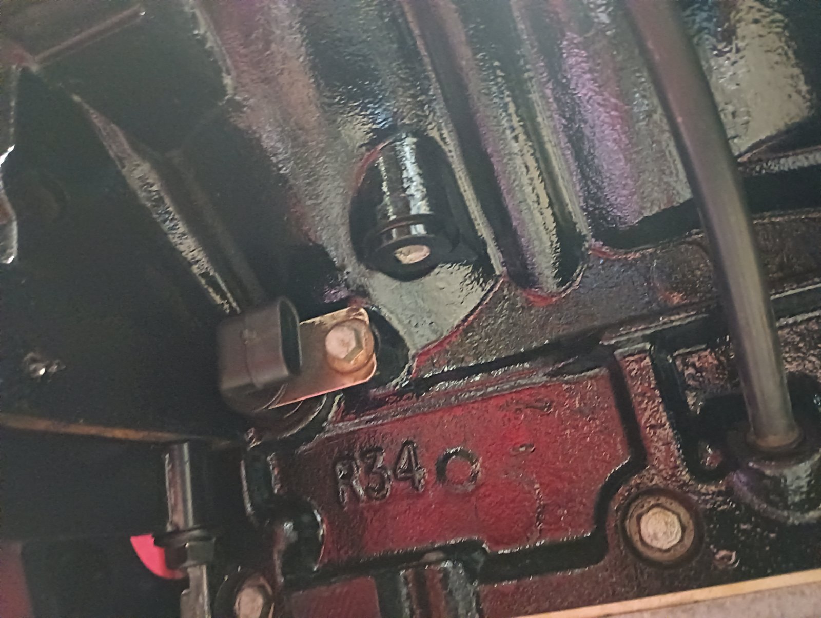

Yeah, I bought that socket set because my other set didn't go that big.
So it's a 17 mm on that large one. I actually didn't remove the one near the starter side (I just painted over it too). I checked and that one is a 8 mm.
Photos for reference.
