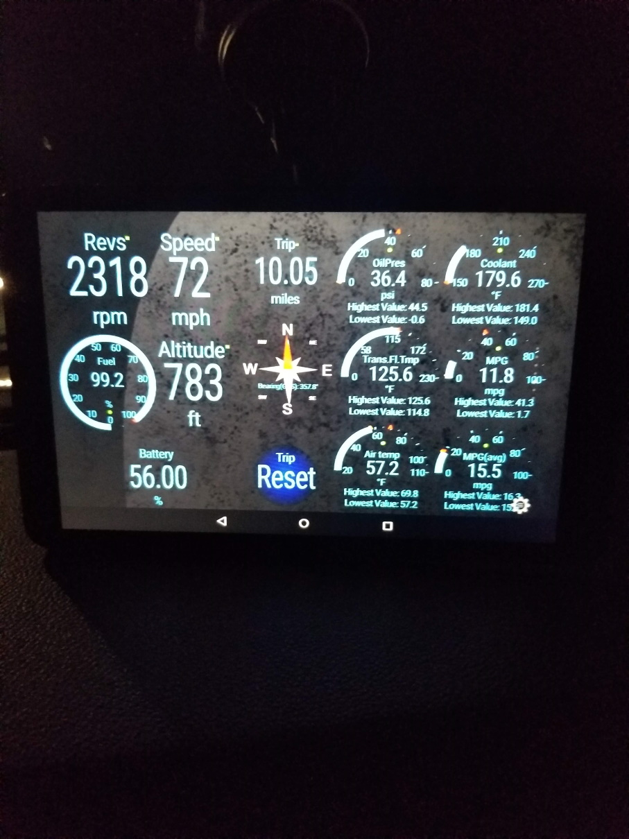

I was getting s steady ~220* in stop and go traffic when it was 110* last weekend. Left it idling running the a/c that day and I saw about 200* trans 220* coolant. That is with an upgraded 12x12" transmission cooler, in a recently flushed system with a brand new waterpump.
