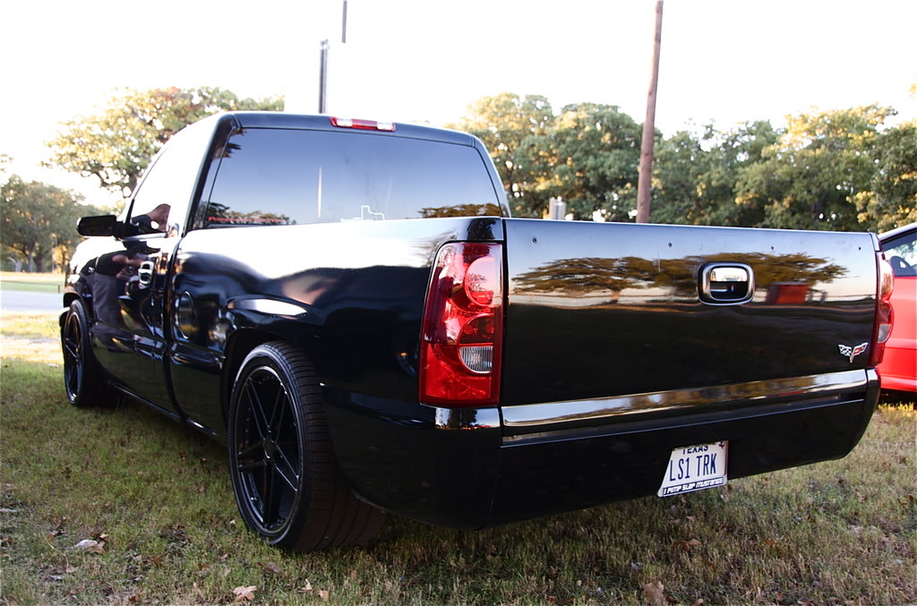

its a totally different bol patteren bro but doesnt mean you cant your going to have to run adapters and spacers since zo6 vette all thoese wheels are flush but ill find a picture of what it looks like on a truck i did !!!

Wow! Nice 1low!!!!
