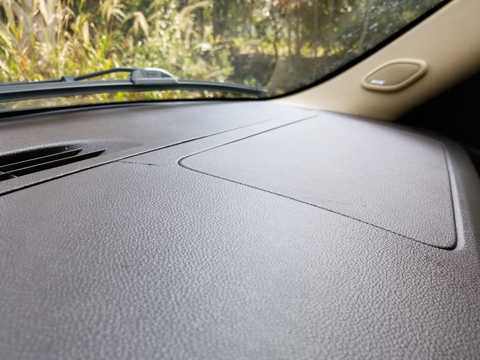

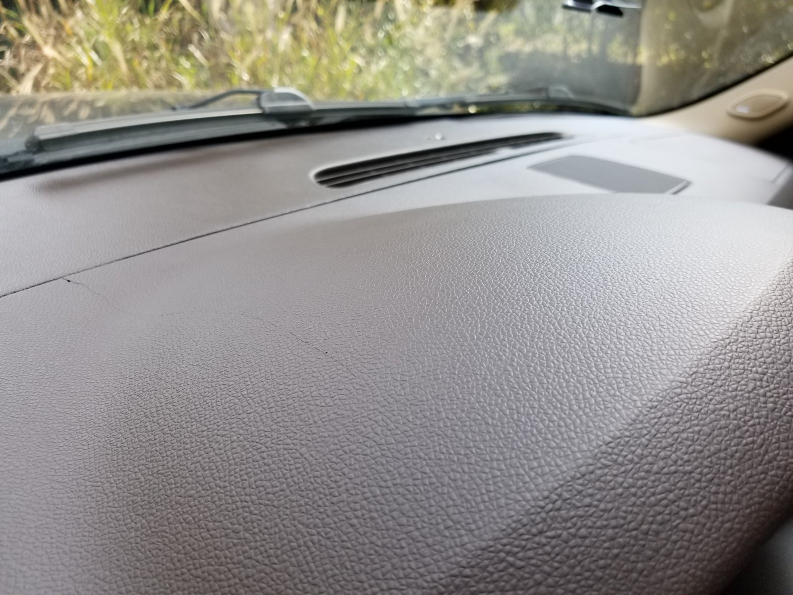

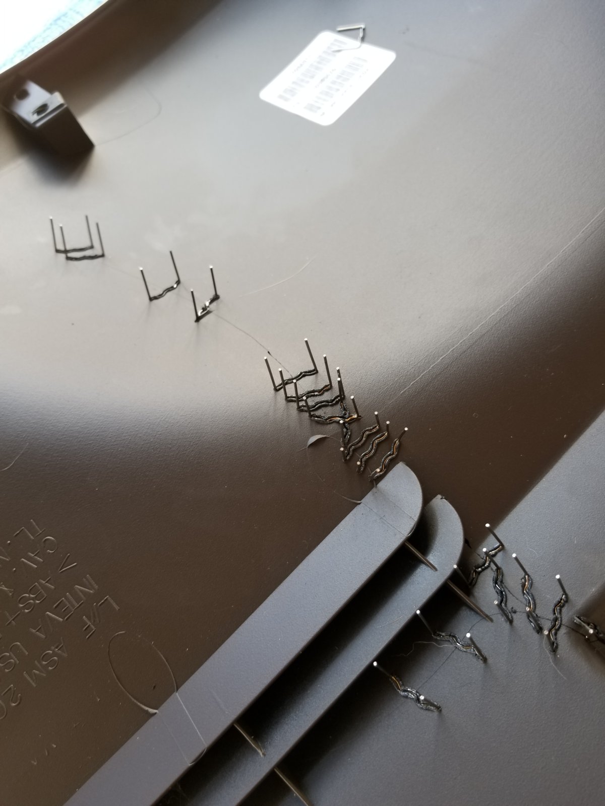

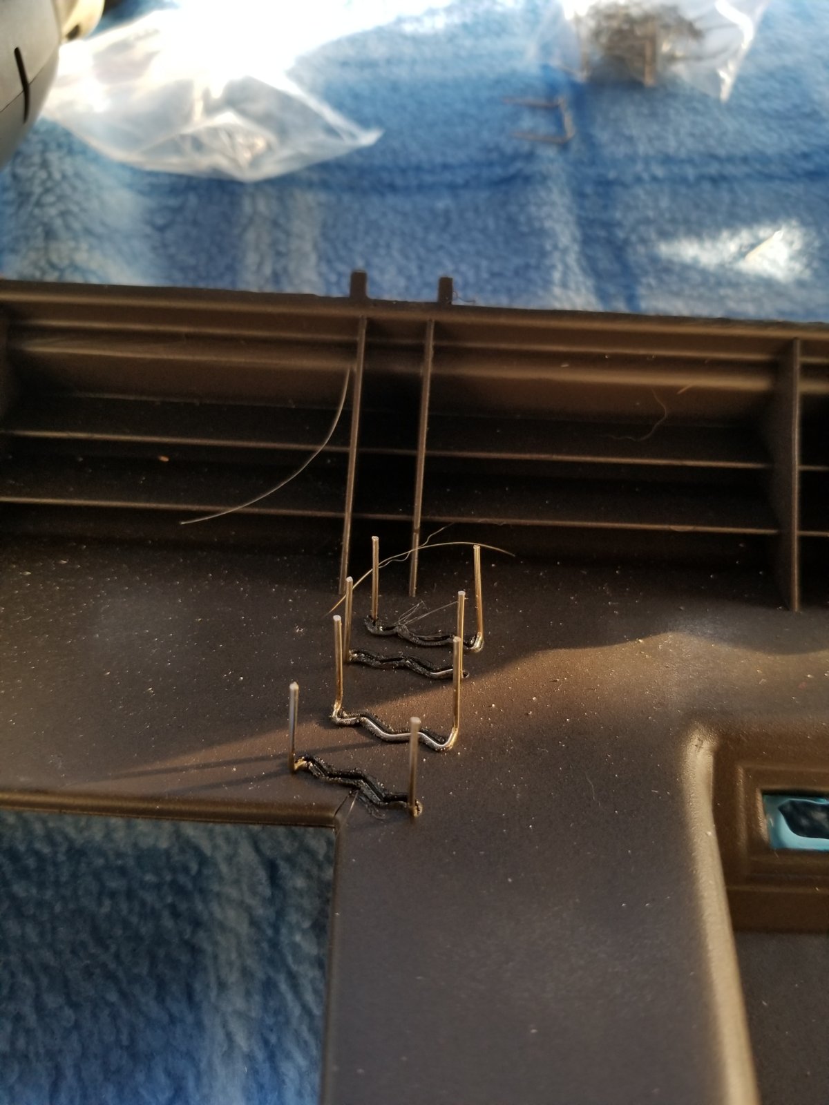

This gun melt plastic staples into the dash so that when it cools, you have some metal reinforcement around the crack. Here is a couple of pictures of my repair

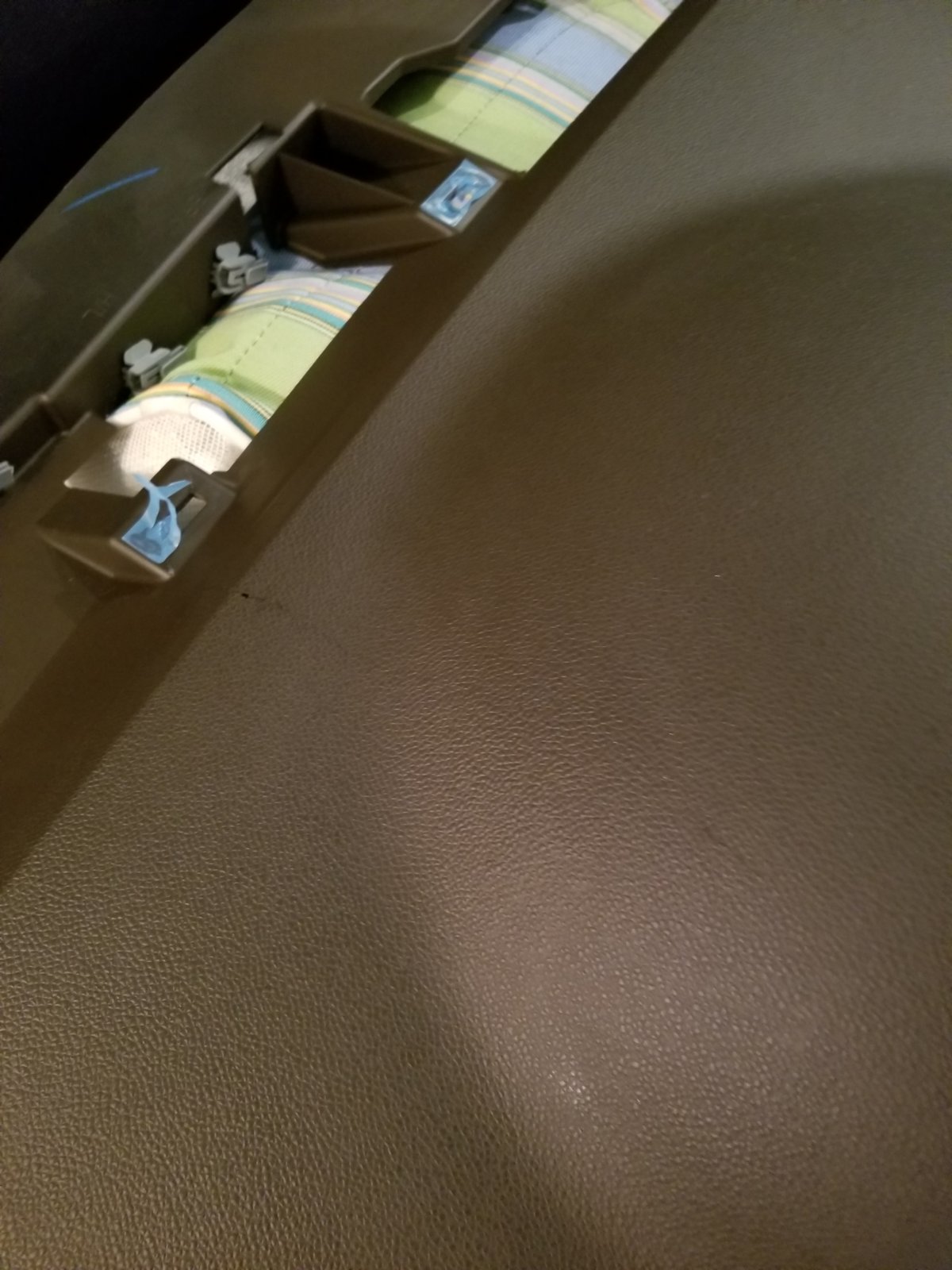

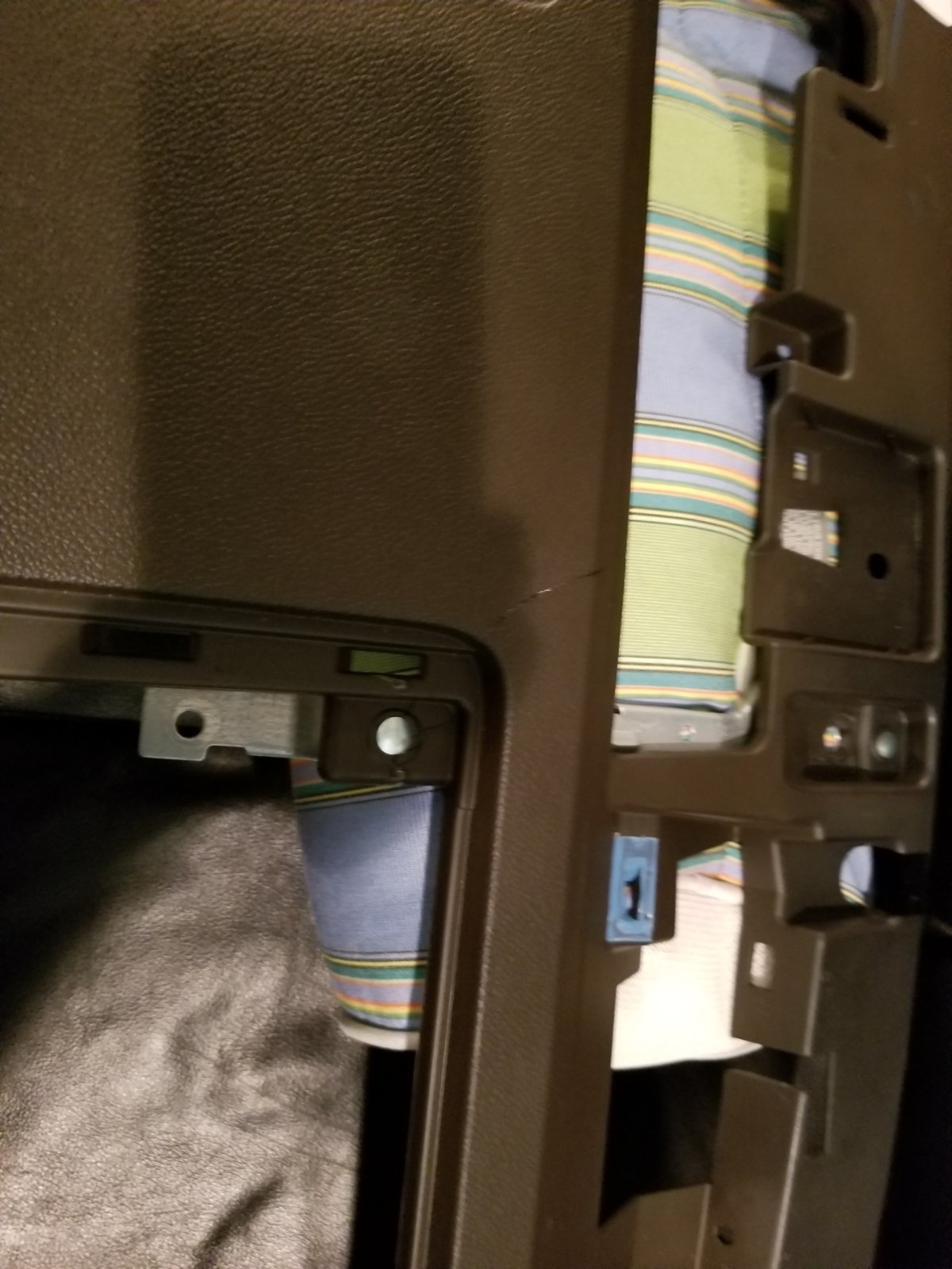

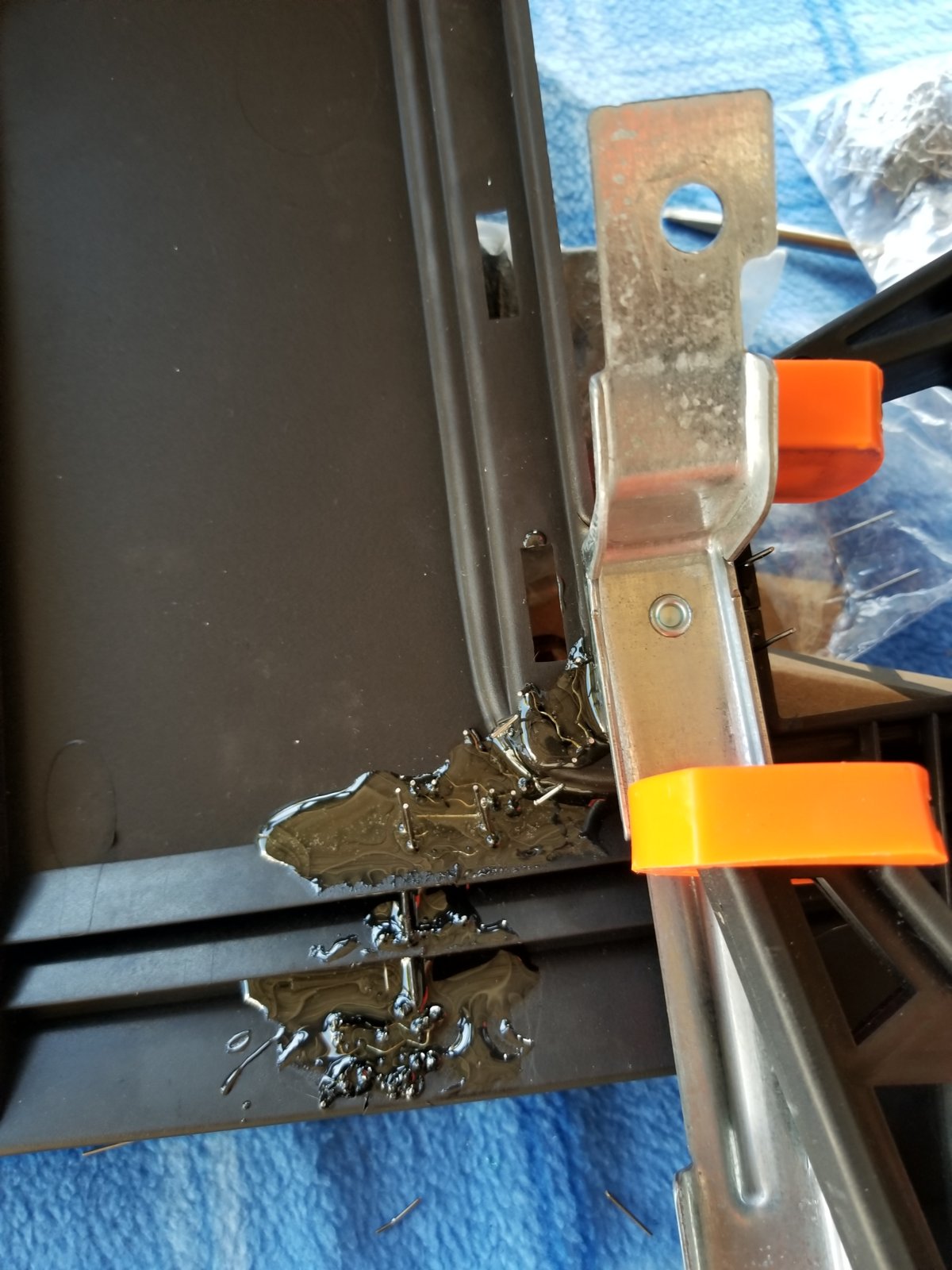

After putting in a bunch of these staples I then used a plastic epoxy for additional reinforcement over the staples.

This is over the driver dash pod
and this is the passenger airbag

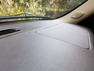

Sure here are three pics
Above driver dash pod crack
Here is the airbag crack

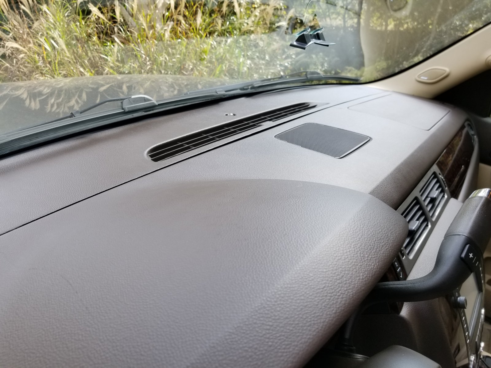

The full dash here.

How do you know how far to imbed the staple?
What if you heat it up and you go to deep?
Just asking. Great job.
Thanks! I see your in NC I'm down on the coast in EI
Yea that was the tricky part. I first tested with some other material to get a feel for how fast this heated up. It does have a heat adjustment dial so you can tweak it a little with that. What I found is that if you lay the staple on the surface pull the trigger to start the heat as soon as it starts to melt let off the trigger and then wait 10-15 secs for it to cool and that worked fine. This was at the 1/2 mark on the heat dial. Once you get a couple done you kinda get a feel for it and can move pretty quickly.. My wife actually brought me a shelf from the fridge and I was able to repair that so I have wife approval of the tool purchase which is always a good thing!
Oh, and the tool comes with several staple types for flat and curved surfaces so you have a lot of choices.
