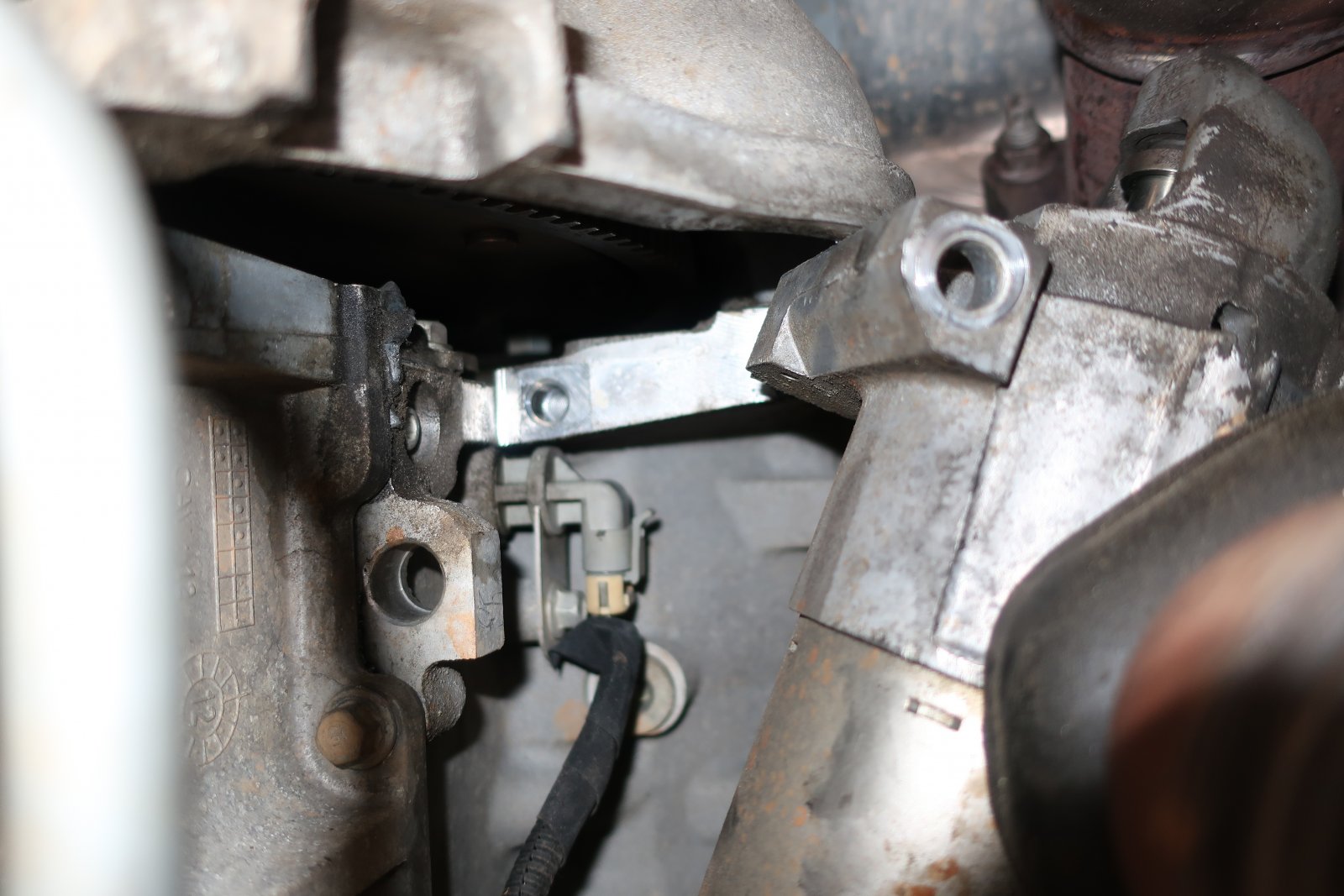

Well you’re lifted so you can just crawl right under there. It’s pretty straight forward. 2 bolts holding the starter. I think 13mm or 14mm. Just move the starter out of the way. Doesn’t need to be completely removed. Then reach up in there with a 10mm for the sensor and it comes right out. Be gentle with the wiring, it’s tucked under the manifold and exposed to a ton of heat so it will likely be brittle
Source: I’ve done this about 10 times this past month. Fingers crossed you’re situation is just a simple sensor

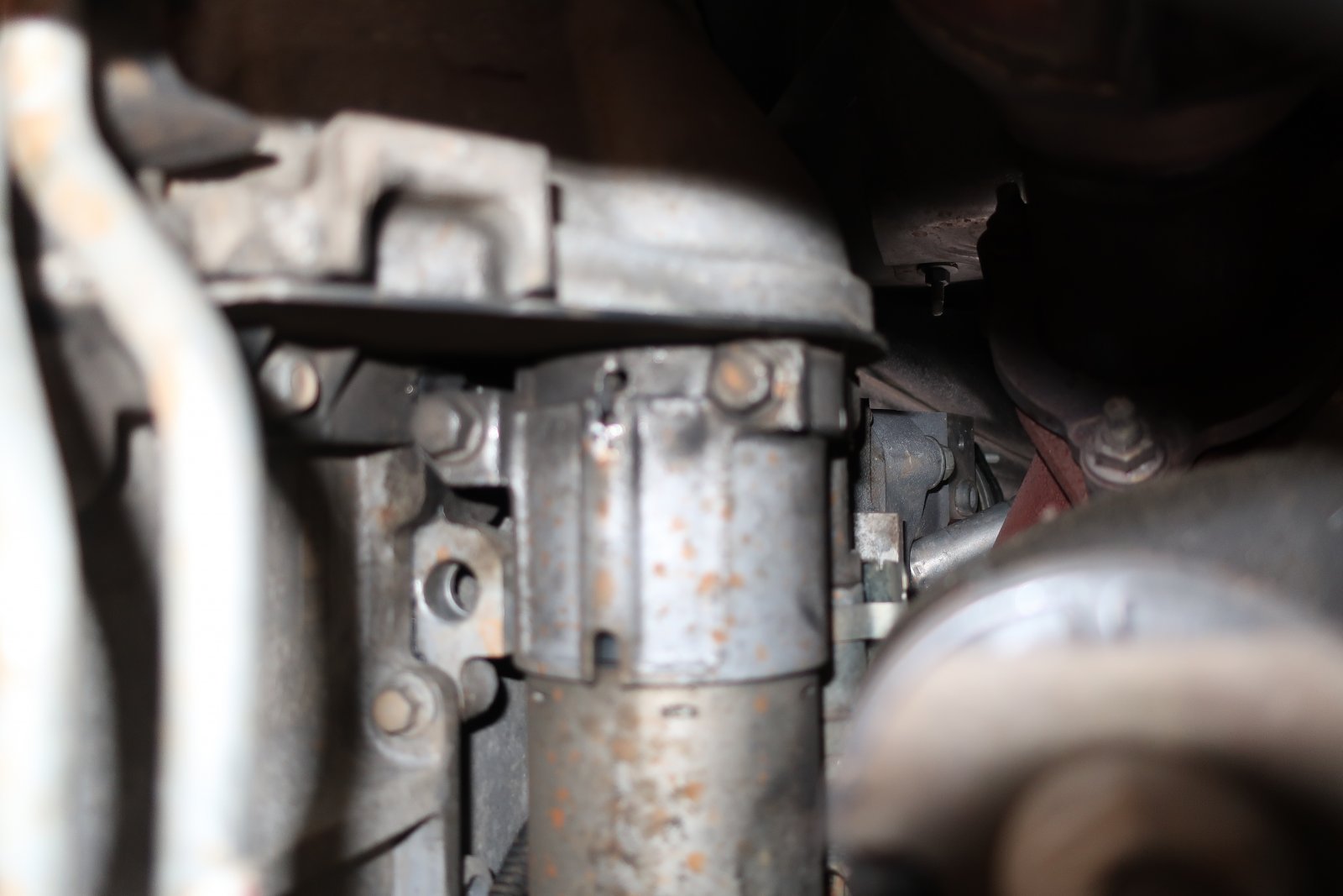

Got a pic for the crankshaft position sensor? lol I thought that was it but it was the cam sensor on the front I guess by the balancer
it's behind the starter, you will need to disconnect the battery then unbolt the starter and drop it down and maybe the bracket behind it.
when you go to pull the sensor out spray it up real good first with some kind of lubricant and then start by twisting back and forth slowly then ease it out they are known to break apart and then you will be fishing pieces of it out of there, when you put the new one in lube the seal so it doesn't get messed up and start leaking
probably going to make life easier by removing the front right wheel as well.
