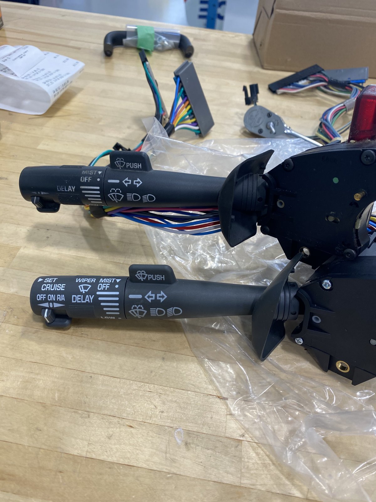

I have a 1999 GMC Yukon . My cruise control has died , what do I check? Thanks.
I recently changed my Multifunction Switch (Turnsignal Switch) because of the constant ticking noise. My cruise control had not worked for about 5 years. Cruise Control is now operational again.
