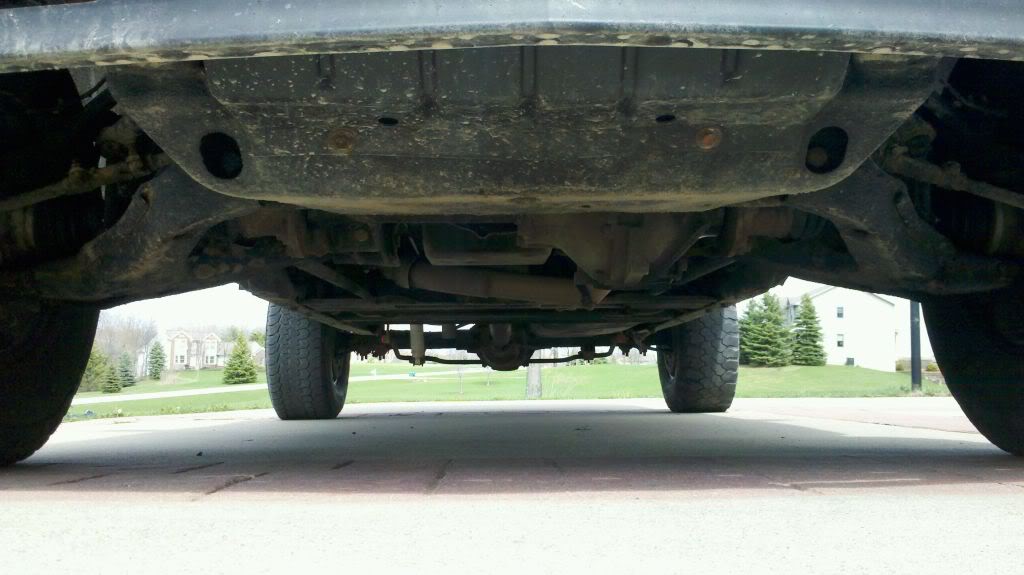

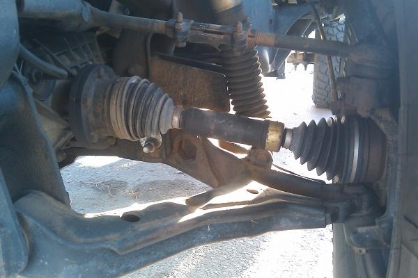

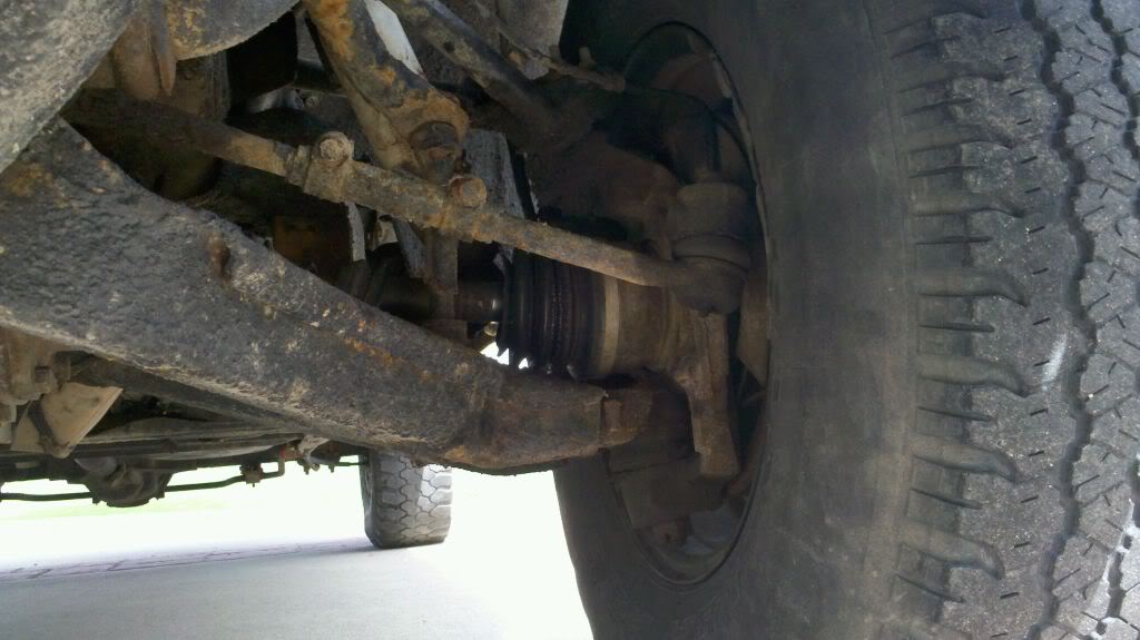

^^^^on a lift is the max droop thetruck can have and it will bind this way. Can you take a picture of the front suspension while the truck is on the ground? This will give us a good idea of angles and so on.
Brandon X
Brandon X
Nov 25, 2009
1,360
Michigan
Yeah I can take some pics. I'm not sure what angles but ill take a few.
