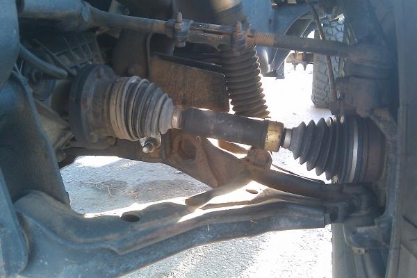

Here's some pics. I was told by 2 mechanics that the shafts were binding, one of which does suspension work on several cars a day.

Your CV angles are stock looking. Are the upper control arms new? Everything appears to be stock to me?
Are they saying they are binding from to much angle or something I am missing here? My angles look horrible compared to your truck

Well for one thing if you look at the CV the boot has come apart so there is no grease in there. Cant tell about the one on the passenger side though. Could be your problem

yeah... those don't look to be binding at all unless your joints are gone under the boots...

They don't know why it's binding, they just said they are. It could be because both boots are ripped and it's flinging all the grease out.
