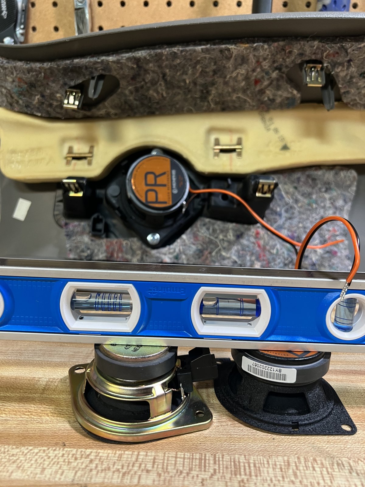

I replaced my rear pillar speakers in 2001 Yukon w factory amp, without Bose. I used Memphis Audio PR27s. Fit was perfect. Depth and mounting are very similar to OEM original. See pics, I rotated speakers 90 degrees and drilled new pilot holes into the plastic pillar back-body, added sheet metal screws at 9-o’clock and 3-o’clock. Then popped in the original plastic pin back into place at 12-o’clock providing a third point of purchase. And added an inline Crutchfield high-pass capacitor/coil to filter out bass below 150 hertz. The finished look is completely stock.
It’s indeed a filler speaker, not high end or punchy bass. I think the advertised FR on the Memphis Audio PR27 is 200-12,000 hz.
Speaker runs off the factory amp in parallel w rear door speaker in my rig (but I think the really correct way to do this would be to add a surface mount tweeter and full crossover, then drive this new mid/tweeter combo from a separate 2/1 subwoofer amp using the new head unit rear channel RCA signal to supplement the rear channel signal from the OEM amp).
I’m happy with the upgraded sonic results I got using the OEM signal feed off the rear channel amp. That amp is adequate, in my opinion, for everything except subwoofer. My simple before-without/after-with eardrum test was convincing. All the original paper cone speakers in our GMT800s are trash by now. If you haven’t replaced yours, you should.
