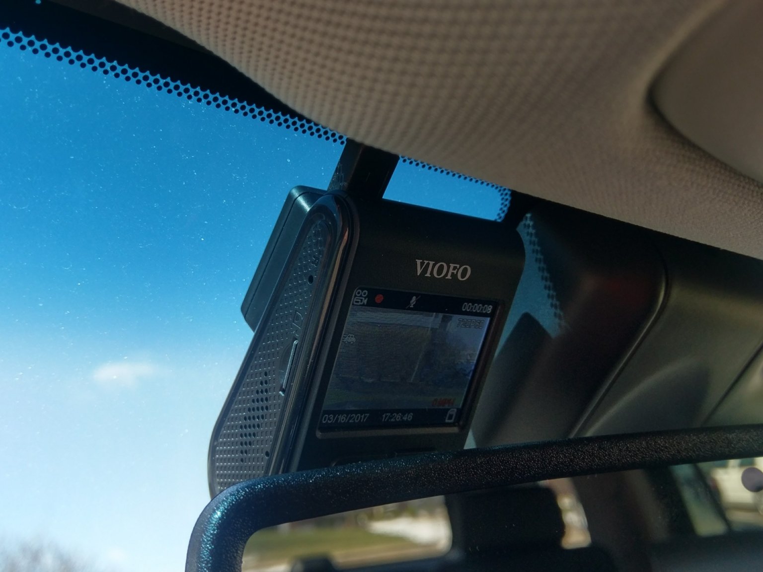

I did this as well. Removed the sun visor, down the pillar. Into the fuse box on its own fuse. I have 24 hour constant power now.

Looks great Glen how long did that take. Camera looks good what kind did you go with
