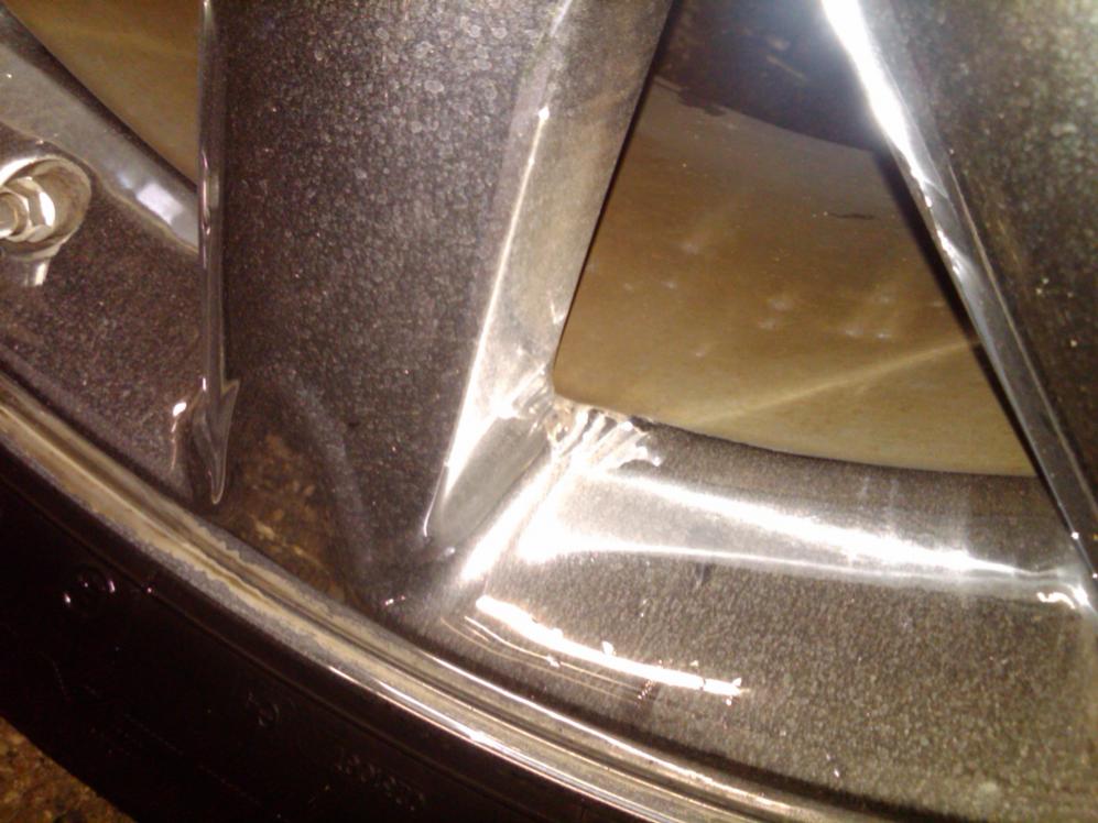

Have an 07 Denali with he 20" chrome wheels. Noticed the other day, there are a couple small spots where the chrome is peeling on the wheels and not to happy about it. Have others seen this?

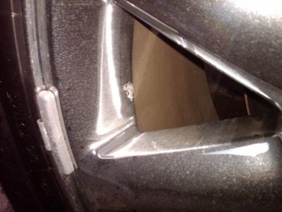

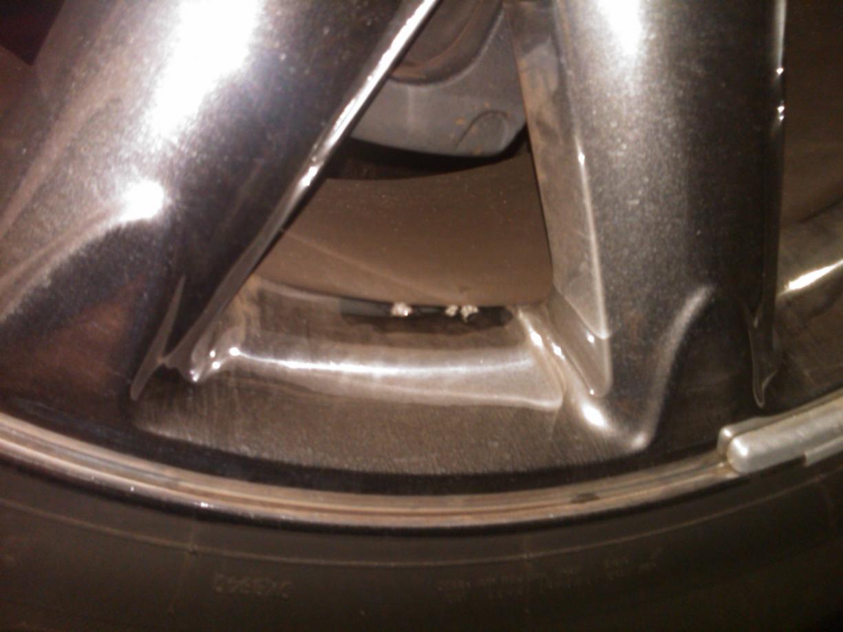

Those of you that have had them replaced, how bad were they? Did the dealer give you a hassel?
I attached some photos of whats happening on my wheels

Well that will be easy to say, have never used any products on the wheels only washed them. Will contact the dealer and see what they will do, hopefully there wont be hassles, my family buys a lot of vehicles from them, on the second Denali right now.
