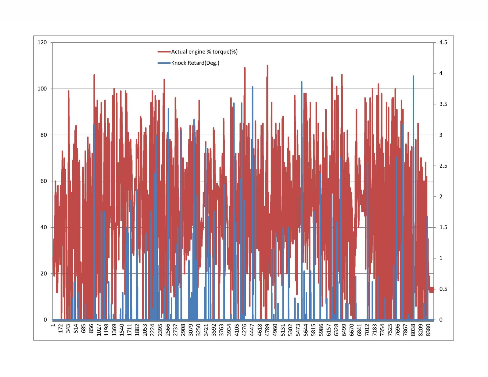

As far as wondering about Premium fuel vs Regular fuel, I have no data on Regular fuel and I do not plan on gathering it on my vehicle, but look at this graph that is for a 2 hour, 15 minute mostly highway cruise on a reasonable flat area, there were some grades, but nothing major and notice the amount of spark retard in the blue. The red is the engine torque while cruising, notice the amount of torque useage above 75%. While the spark retard values are not signifigantly high, just think about if Preminum fuel was not being used. BTW this is 93 Octane, however, I also realize some areas in the US may only offer 91 Octane as Premium.

curious where this graph come from? if you're able to log, and you log knock count. not they timing retard. there's a lot of retard tables in the tune, anything don't burst knock, to activity knocking.
I do agree, if your dead stock di engine is knocking on 93 just driving around normally. it's not going to be happy 300k miles from now, if it makes it

Pulled data from my vehicle via ODBII port and then had to work to graph it.
Unfortunately I do not have knock count reporting at the moment, still trying to crack this one, but the fact there are so many "Knock Retard" events and they are in fact called "Knock Retard", I feel this is indicative knock events and could be a much a bigger issue for people not running Premium fuel.
Understand most of this driving was while operating with cruise control enabled as well on reasonably flat highway, so likely a bit more subtle throttle response than my right foot.

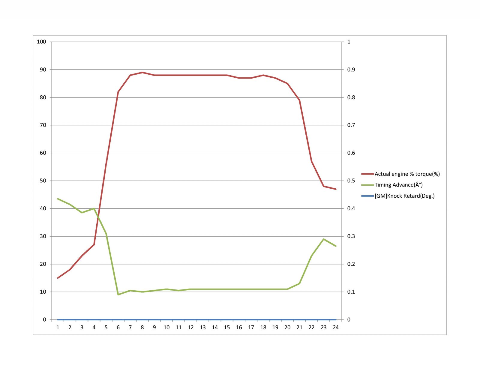

Agree there are other timing retard events that may not be due to knock sensing. See more below along with graph.
Below is a scary graph of a timing table that is pulling 30 degrees!! of timing during tip in throttle and under heavy load. Notice the "Knock Retard" is flatline across the bottom and is not a contributor to the timing being pulled. I cannot image how much power it being lost due to this timing behavior. BTW, this is all with the engine RPM never exceeding 1700 RPM! Cruising at around 70-75 MPH while pulling a slight incline on the highway. Transmission typically never shifting out of 10th gear.
A pretty good source that did some advanced testing on this later generation engine led me to believe this was GM's way to help reduce/eliminate LSPI. But this is a rather radical reduction in timing at 30 degrees. I feel there are errors in the timing maps based on what I am seeing. I dealt a lot with this back in the early 2000's with a number of manufacturers and this was actually a major error on the manufacturers part.
Not in this instanced where I have captured the timing pull under heavy load, but under other driving conditions, other radial timing pulls usually can feel like misfiring during tip in throttle under light to moderate load. The issue is not misfiring, it is power pulses due to the dramatic loss of power when the timing maps are being switched in and out. I can feel this power pulsing happening in my truck, it is not DFM, it is not Knock Retard, it is timing maps switching on and out causing the misfire sensation. No misfire indications at this point either. Again, the graph below is not indicative of the timing map switching causing power pulsations.
This graph is just an example of how the timing map can pulling timing without a knock event as there is no "Knock Retard" contributing to this event.Load Timing and Knock Retard.jpg

I guess these are global b or whatever they are calling the new ecm's that haven't been cracked by hptuners yet?
try looking for cam timing, and see if it's retarding the timing because of the vvt retard.
there's so much going in in these di engines. you need injector timing event as well.
expensive test but if you can find a pump in your town with 100 octane unleaded, or they say vp fuel has a good booster that actually works. guys use it for extra safety doing dyno runs for 93 tunes. if the retard goes away, you are definitely on to something. Sadly I have no idea how to fix what yours seeing.
could try a good catch can, in hopes it's sucking in some pvc oil causing knoc?

No, 100% stock except for a catch cap and Range AFM device. At some point I'll likely pull the range device just to make absolutely sure it's not contributing to the timing map behavior but based upon what I've been led to believe there is a lot of that programmed in to the stock ECM.
