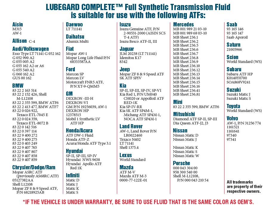

Above chart is for LubeGard's 'Complete Full Synthetic ATF', which among a plethora of others, covers
Mobil's PURE SYNTHETIC IMPROVEMENT OF GM's DEXRON-HP, DEXRON-HP, & DEXRON-VI.
