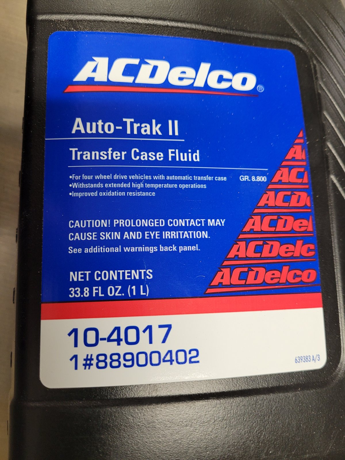

Iirc the NBS uses a different design.
Wasn't the older design "auto track" required to use that blue Auto track II fluid?
NNBS got the updated design that was able to use normal ATF.
It is different. The BW4482-NR4 is the AWD transfer case in those. It has more features than the 4485 in the 900s. My eyeballs are bothering me today, couldn't find what the latest fluid recommendation is.

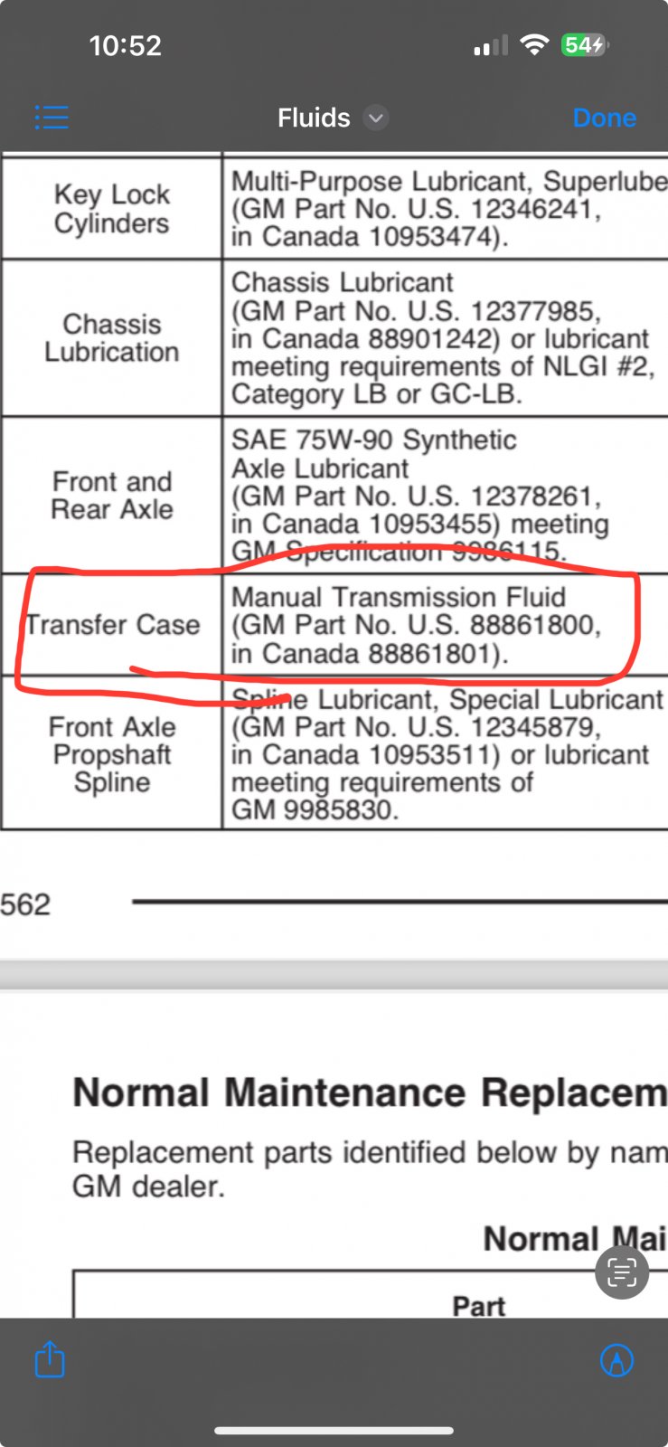

The manual for my 06 Denali XL calls for 1.5 qts of Dexron III to be used in the transfer case. This vehicle is AWD. Since Dexron III isn't available anymore, what fluid type should I use? I read that at one point, GM recommended Dexron VI because it was supposed to be backwards compatible, but soon after they put out a warning that it wasn't good for transfer cases.
Any recommendations?

Ah ok yes you are correct! I have full time AWD which per my build sheet is the BW4482 transfer case. I am however a little behind on transfer case maintenance… Yeah I know bad truck owner. The last time I had it checked out was in March of 2019 before a road trip to mammoth mountain for a training camp…. Ooops. Lol. It was drained and filled just before that road trip with fresh fluid. It has seen a lot of miles since then so I’m probably WAY overdue for a transfer case service. So I will pull the maintenance records as the shop did it for me because I did not have time to do it on my own at home. I will see if the service write up mentions what fluid they put in it, I will also check to see what my owners manual recommends for fluid in the transfer case. I should probably try and get my transfer case serviced in the next few days. Will post back shortly.
