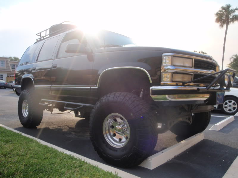

heres what it looks like now.
---------- Post added at 07:46 AM ---------- Previous post was at 07:45 AM ----------
sorry bad picture but its all i got right now.
