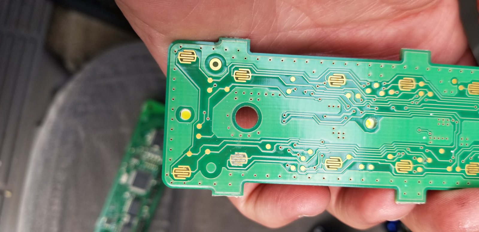

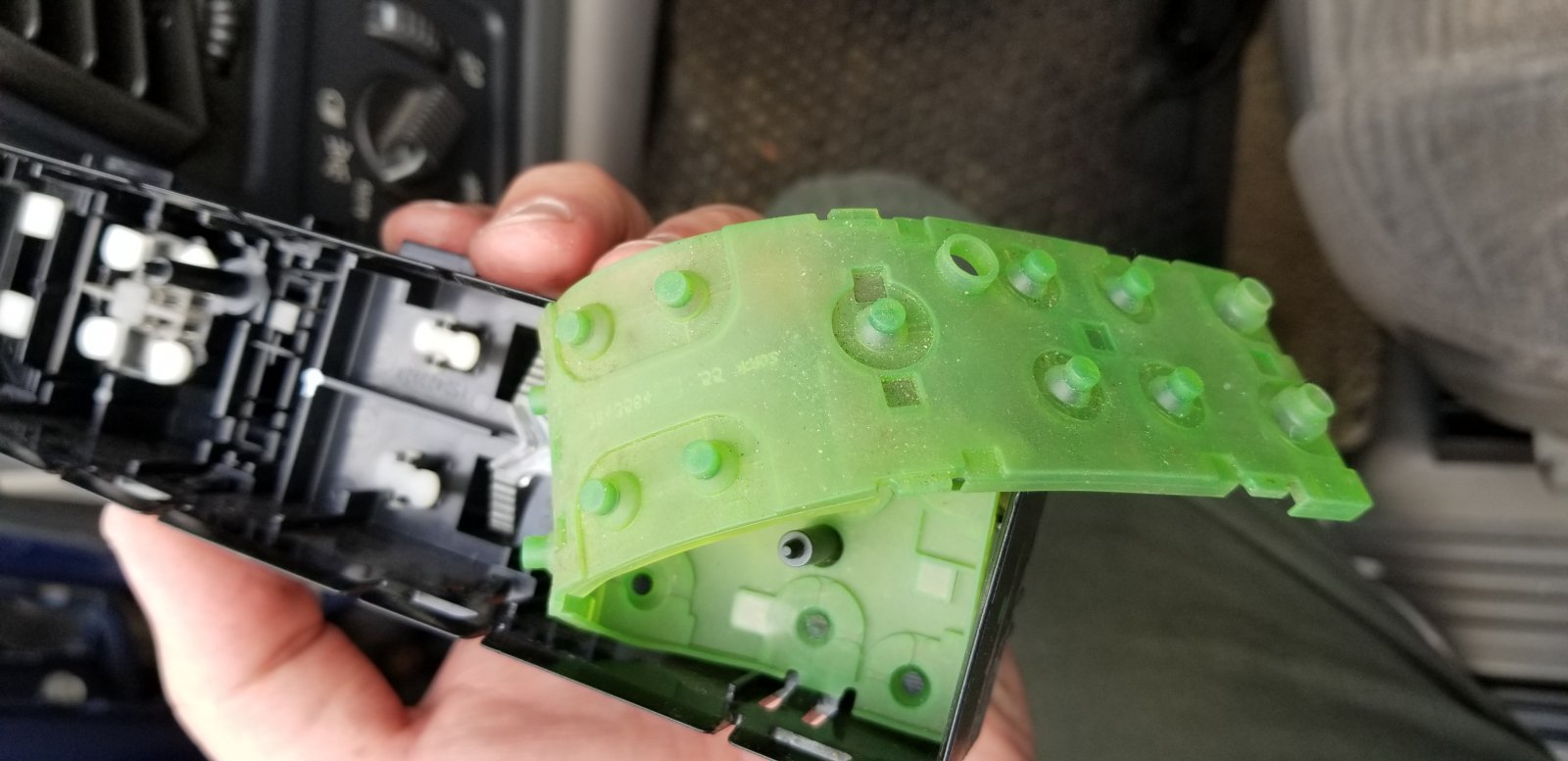

Reading through this thread and I am having intermittent issues with just the drivers side window. The passenger window rolls down with express. The rear windows roll down to their 1/2 way point. The rear window roll up while you hold the switch. The passenger window rolls up while holding the switch.
The main problem is the drivers window. Sometimes there is no action immediately when I hold down the switch. Sometimes I have to give it a couple depress actions to get it to roll down while I hold it (no express down). It seems at this point express down is not working properly. There is no noticeable click when I roll it down. It does roll up as it should. There of course is no express up option here.
Per above posts, can just the switch inside the entire unit be replaced or are we looking at an entire new assembly? I could not find just a switch listed anywhere to replace as what was found was the entire assembly for replacement.
