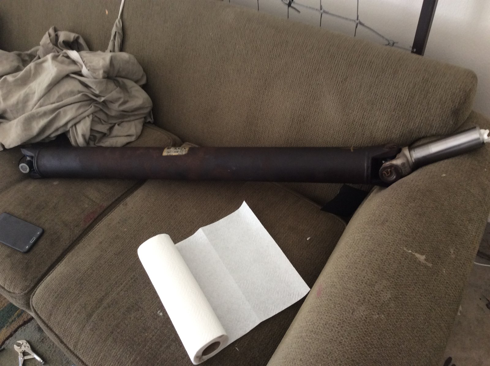

imo, pull the drive shaft and you will find your problem. someone installing new u joins could have absolutely messed up pressing them in. slip joint dry, trans extension bushing shot.
You are right! Finally pulled driveshaft yesterday and found the problem. I bought the Tahoe 1 year ago and u joints looked new but like you said someone pressed them in wrong because the rear ujoint was so tight(binding) and the slip yoke dry. So I tried to relieve some pressure on the rear ujoint, and could not really fix it to where it was any use....but I did grease the slip yoke, and removed the small layer of rust on exposed part of slip yoke, put back on and made sure to center the rear ujoint on to the rear diff (noticed that the driveshaft wanted to center itself a tad towards the drivers side rear wheel) so I bolted it back on making sure to guide the shaft on center....drove it and even though I need to still change rear ujoint for a new one, the Tahoe drove and felt so much smoother and actually seemed to shift better and felt only a very little soft vibration 1 time which I know when I get my new ujoint today will take care of any vibes on the driveline. But thanks to all comments, because they were all pretty much correct. "Pull the driveshaft and you will find your problem".
