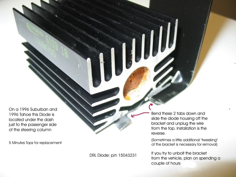

so simpley unplug the diode? I tried pulling my fuse before and nothing happened
yep, just unplug it. the fuse worked for me, but i still had the green light on on my dash. now the green light is no more.
