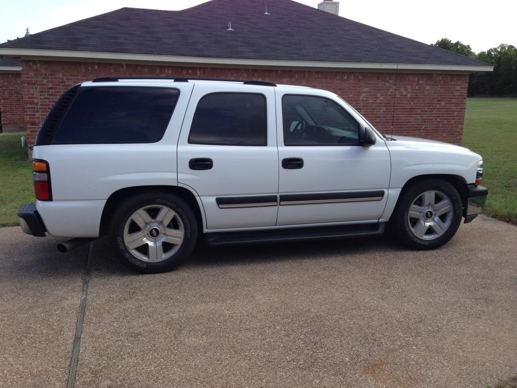

Didn't get started until late yesterday morning but got the drop kit installed. Didn't have a chance to do the brake upgrades because I forgot we had a wedding reception to attend early in the evening. Drives much better now than before! Tweaking the torsion bars today and cruising around and then re-measuring. Dropping off at the alignment shop tomorrow. It is much lower than I thought it would be, but I love it.
