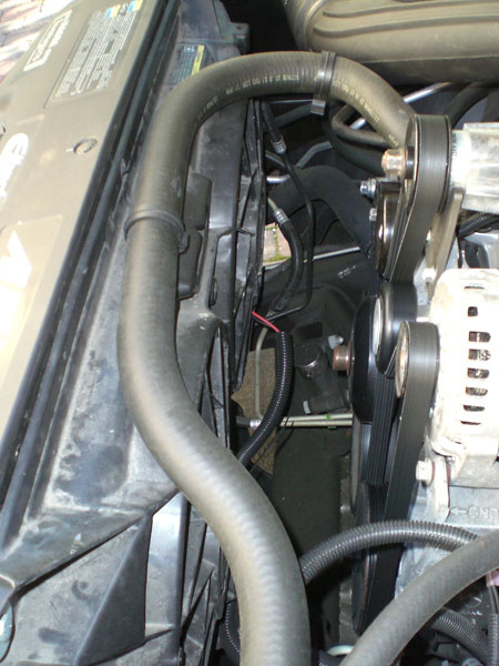

Justin turned on pin 42 when he did my tune. All I had to do was disassemble the connector on the pcm harness, run a wire off the ac compressor, run the power cables and connect the plugs. Easy stuff.

what if i dont want my ac on all the time? could i just have constant power to them and then when the thermostat tells them to come on they come on?

They kick on when the AC is operating, otherwise they function normally. This system is essentially OEM sans the harness, call Justin or Jenna for one of those :cheers:

I've been driving kinda fast and still have a solid 3/4 tank left, bet I got 1-1.5mpg. Truck is noticeably quicker, similar to the power gains I had from the intake but the throttle response is way better.

gfdi... i want to do this mod so bad.... would you say it was possible to swap the e-fans from one truck (05 silvy) into my truck and then swap my belt driven fan into his truck? Would i need anything special to make the belt driven fan work in his truck? He tells me if i do some work on his truck, give him my old intake and detail it he will let me do this swap... as long as i make everything work in his truck that is

Just drop dime on new ones and a harness, ***** only $300 and they'll be brand new. Fans are louder than I thought which isn't an issue for me but others may want to consider this before the swap if you wanna stay quiet.
