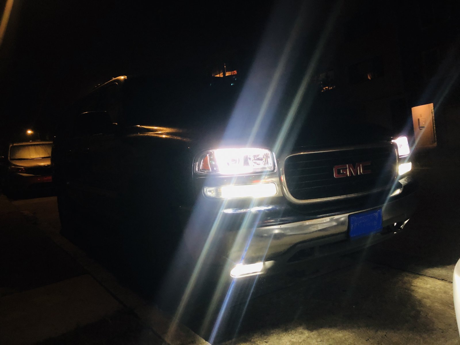

Ok, it’s the bulbs. I had two different types in there (to compare which is brighter), I swapped them around, and now the DRLs come on when parking lamp switch is on, but not the parking lamps.
Just need to order another set of the bulbs that work.
Given that they are LED, I should be able to get away with this connection set up, ya? No relay required?
Yep should be fine.

The side marker lights flash simultaneously with the turns signals (not alternatively), which I don’t mind, but aren’t they supposed to be illuminated otherwise when the parking lights are activated?
