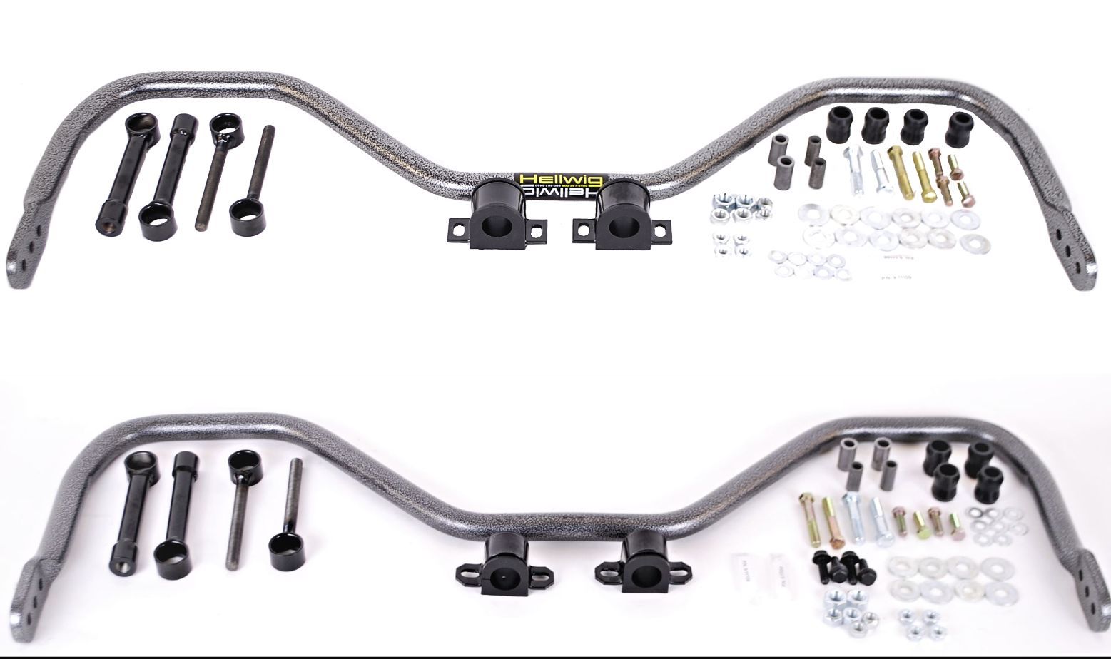

short answer is the front sway bars are the same for all 07-2020 1500 suv's 2wd/4wd/awd, with or without autoride (doesn't matter)
THE REAR apparently is different for 2015-2020, 07-14 have different rear part number
the front is also the same for 07-18 1500 pickups (or 2019 LD), the rear is obviously different because they have leaf springs instead of a floating rear axle
2019 and up on the pickups (front) is questionable haven't looked to see what was changed up front if anything.
different for 2021+ suv's (complete re-design)
skid plates are the same for 07-14 suv's & and up to 2013 on the pickups (unless they made a LD)
skid plates are the same for 2015-2020 suv's and up to 2014/2019 on the pickups (there was a 2019 LD)
the only difference here is on the pickups 2014 was a early changeover year so 2014 was the new design for them (skidplate wise so they would get the 2015 version)
in most cases also if the vehicle is lifted or lowered the same applies you just need the correct brackets/end links instead
27,113
41,001
I edited the above, rear is different for the k2's (15-20) front is the same 07-2020
what the actual difference is I don't know haven't experimented with trying them
from pictures they look fairly close the endlink holes are wider, perhaps due to vehicle height differences from the gmt900 to the k2's
top is 07-14, bottom is 15-20
the hellwig endlinks are adjustable so unless the bends are different horizontally then you could probably make it work either way

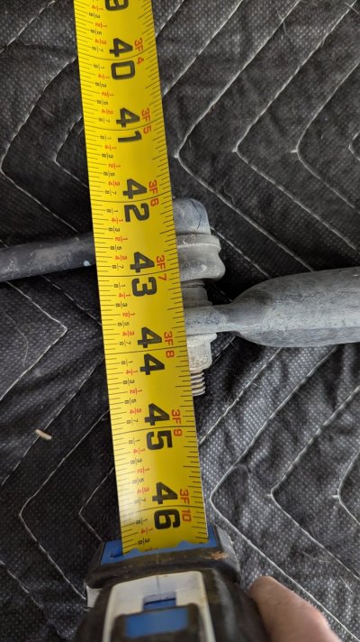

Heard back from the guy, and looks like I might be going up to get them on Sunday. Not sure what time he will be available (He's out of town), and if it's too late I won't have enough travel time. I did notice that there might be one missing bushing, but I should probably replace them any ways. Any one have any input on that? I might end up ordering them ahead of time.

Well, Sunday fell through, I guess he was out of town for work. We are currently set up to go up there this Saturday, we'll see. I already have new Moog endlinks ordered, just need the bushings...but I'm waiting until someone can drop some part numbers\measurements here or I have the bars in hand to measure.

Rear bar is completed. I used some stock Moog replacement endlinks, and Moog K7326 Bushings. Everything bolted right in. What a difference! I haven't sourced front bushings yet, but once I buy those I'll be installing the front bar.
