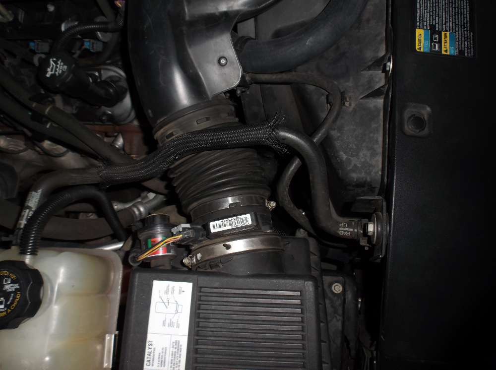

The hose from the surge tank should go to the front inlet of the waterpump not the rear....that hose should run to your heater core..if your hoses don't look like this they are reversed and explains why u see coolant flow in the surge tank..40427e43a47c646aa80a82abcda13fa6.jpg
Sent from my SAMSUNG-SM-G900A using Tapatalk
Yes mine is routed just like the one pictured. Thanks for the info!
