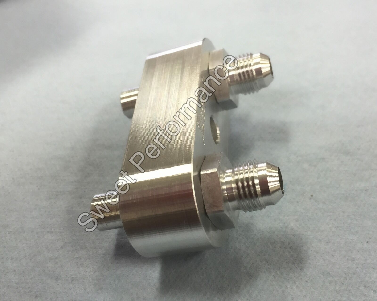

I bought this on eBay and will be making my own lines to the cooler. Its so much easier to use Parker flexible lines. McMaster-Carr is a good supplier. I did this with my Duramax before for fuel lines and they have some modestly priced hose that is rated up to like 500 degrees.
