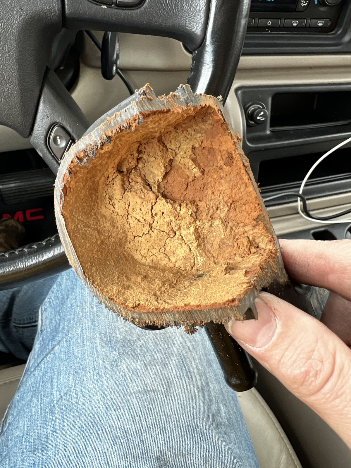

Okay, so a c-clamp adjusted (and double zip-tied in) so there is just a little flow into the reservoir had a quick warm up and kept temps between 186 and 205 on a road test. Thanks for the assist!
Now to work on the fans. Oh, and the dash gauge just died I expected a good bit of wrenching, so no biggie. Finding Something with minimal rust was a greater concern for me.

Ok so it seems the restriction needs replaced. Don't know if you have access to one, but I used a .45acp casing with the primer removed on multiple Silverado. Just slid it into the hose and hose clamped in place.

That’s great! I know I’ve got 9, 10, .40, .454, .45 Colt, .308, and 5.56. Thanks for the suggestion!
Thanks for the temp sensor advice, I confirmed no power to the fans and tested the relays. All three were bad with open circuits across the coil connections. $60 at Autozone and we’ve got working fans and A/C.
