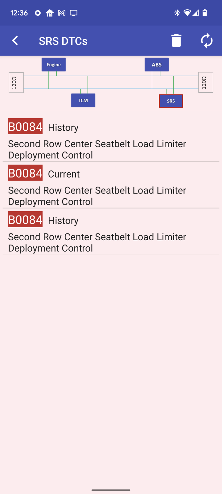

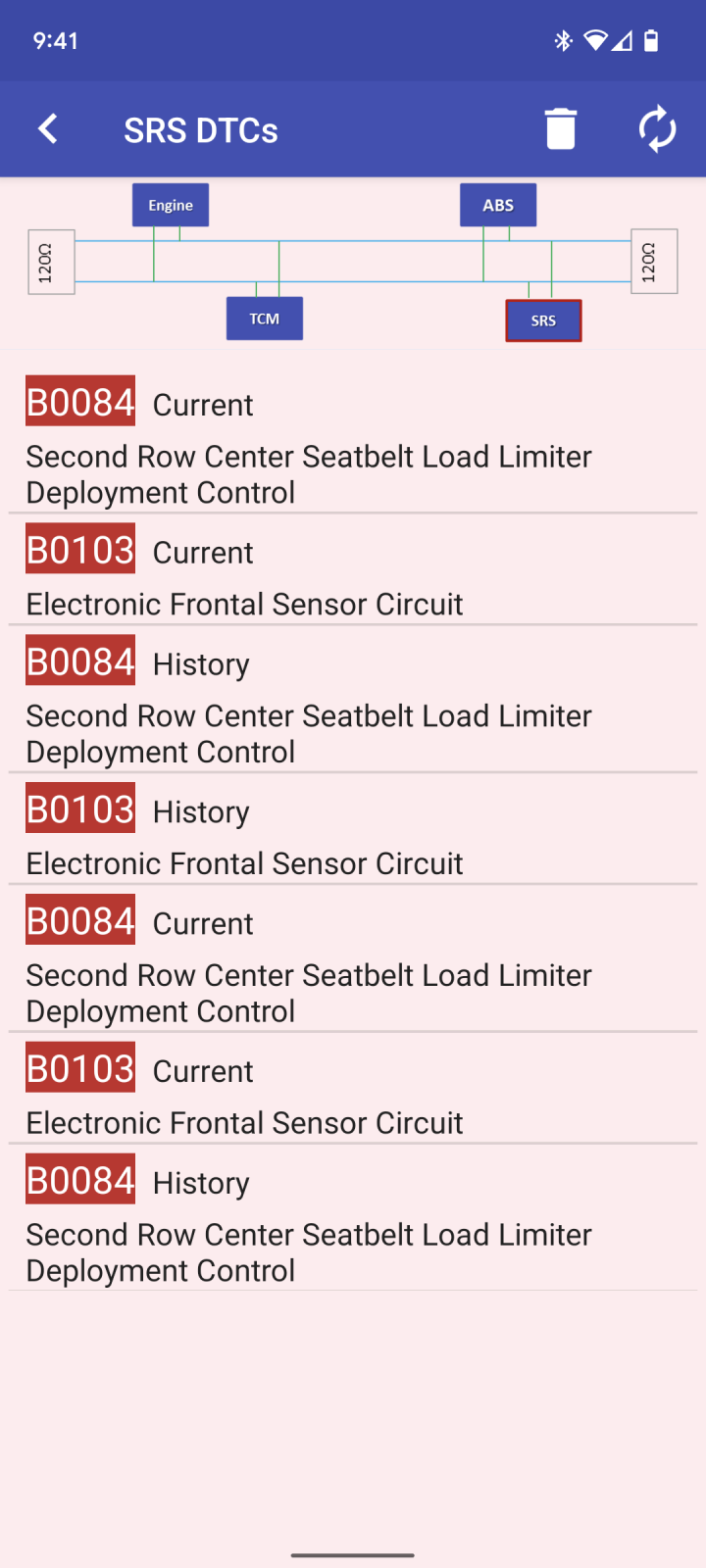

Anyone know how to get this fixed? Swapped in my rebuilt motor and got all these codes I deleted them with he scanner but pops back on right awayScreenshot_20211202-094140.png

Possibly a damaged front impact sensor or wiring harness. Does your scanner show any of the code suffixes that would tell you which one? (see the video for the suffixes)
Unfortunately it doesn't...

Since it's a circuit code you may find a loose wire or bad connector. Worth a try to follow the wires back from the sensors to see if you can find an issue.

Looks like I'll try looking for wires first... And then the front sensor's...

my guess is it's a pinched wire somewhere, probably need to find a diagram of the airbag impact sensor wiring harness and check the harness leading up to the 2 front impact sensors
