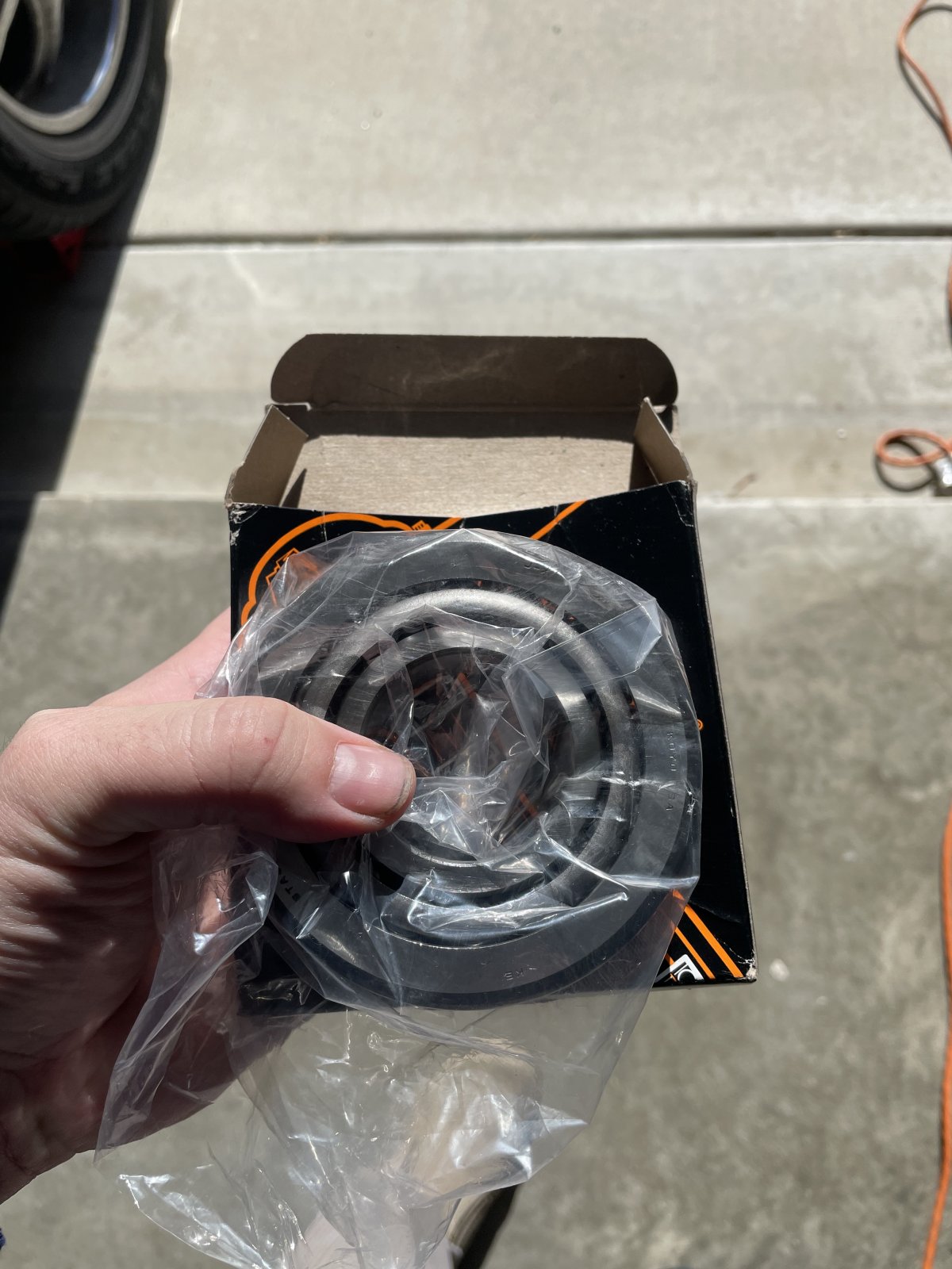

This is an oil pickup. The box was kind of mangled and a little bit open at one end. The pickup looks OK, but I noticed that it does not have any bolts with it. Could these have fallen out of the damaged box? Or does an oil pickup normally not come with bolts?

Not sure on the bolt. But, the original isn't a wear item or TTY, so it's perfectly reusable.
